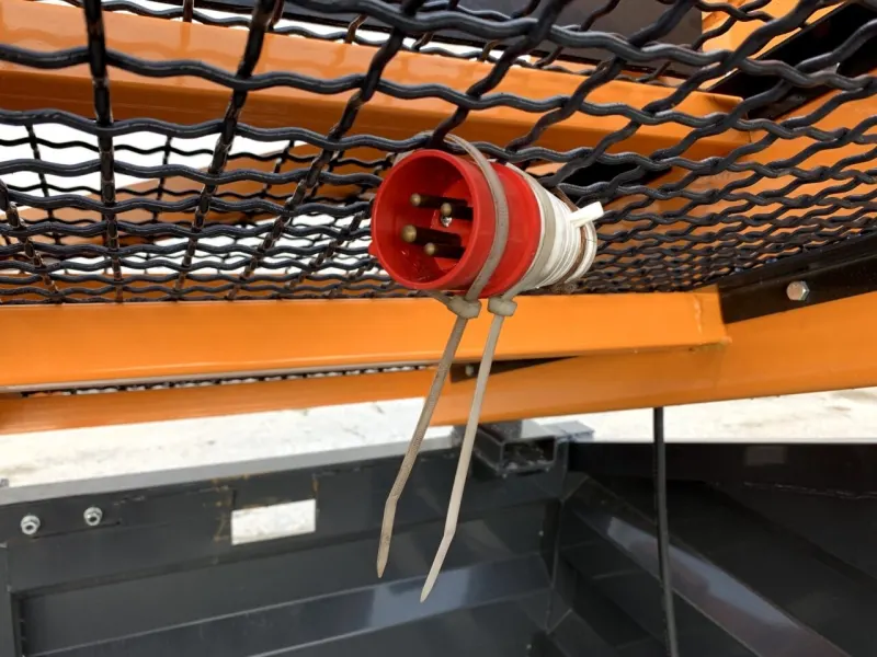

I have purchased a topsoil screen with a 3 phase electric motor OLI MVE 1700/15N-60AO the screen is 2
Corbettdirt
Mining
Nov 27, 2020
6
Corbettdirt (Mining)
28 Nov 20 02:22
I would like to use my Generac 17500E 17500W/26250W Generator to power the 3 phase 460V (plug and play) HOW?
Brand: Paladin Industrial
Model: US70
Size: 4 Ft. x 5 Ft.
Screen Type: Square Mesh
Operation: With or Without Chutes
Features: Fork Pockets for easy transport. Removable partition plate outside the material outlet wall for easy separation.
Motor Brand: OLI
Series: MVE
Year/Serial: 202007 11529
MVE Type: 700/15N-60A0
Force kN: 17
Power kW: 0.75
Rpm/Min: 1800
Hz: 60
Amps: 2.16
Waterproof Socket: Type 114 / 16A-6 380-415V
Uses For Vibrating 2 deck Screen: Aggregate, Mining, Industrial and Recycling
or even an alternative motor to replace the 3 phase for a 50amp 220V motor. and suggestions

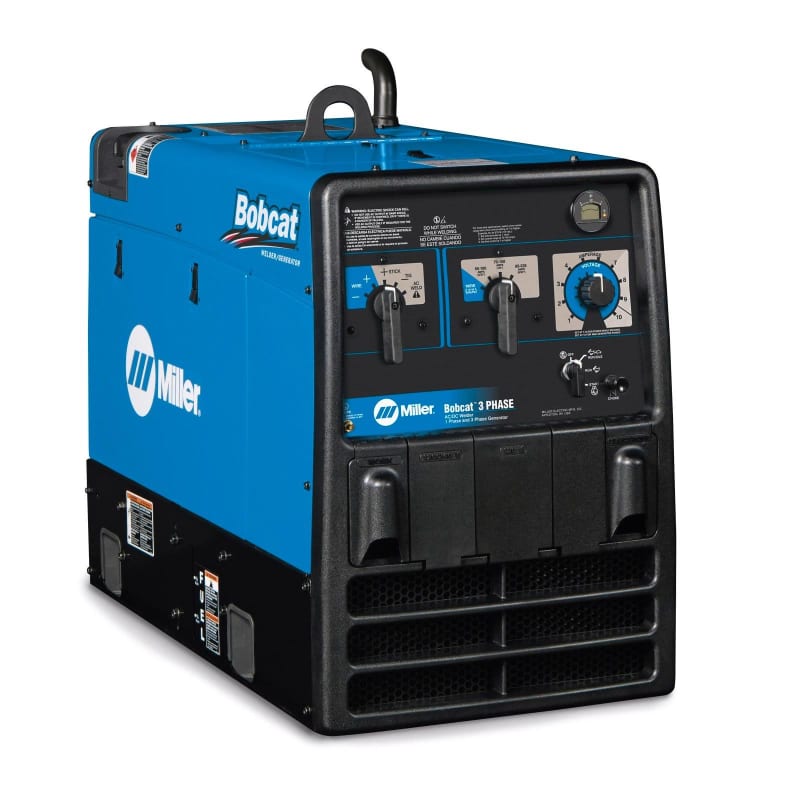

I've been told that the Miller Bobcat 3 Phase Welder 907505 would run the motor. I'm
[URL unfurl="true"]https://res.cloudinary.com/engineering-com/image/upload/v1608363326/tips/MIL907505_704x704_qcsv9m.webp[/url][URL unfurl="true"]https://res.cloudinary.com/engineering-com/image/upload/v1608363638/tips/IMG_1716_phtxzm.webp[/url] looking for a plug and play option.
For a plug-and-play no-thinking-required solution - a 3-phase generator with enough capacity will do it.
Minor digging finds that you can buy a phase converter as well, but the cost of buying both a suitably sized phases converter and a suitably sized transformer is going to put you in the same ballpark as that generator.
That is not just a motor.
That is a motor based vibrator.
You won't find a standard motor to replace it and I doubt that you will find a single phase vibrator.
You may be able to make a belt drive vibrator.
A shaft, two pillow blocks and a pulley.
Drill cross holes in the shaft and install bolts with multiple nuts to create an unbalance.
Spin it with a 1/2 HP single phase motor.
There are others in these fora better qualified than me to suggest adequate construction details.
For safety, enclose the spinning weights in pieces of suitably sized pipe.
If money is no object or if you want an excuse to own a new Bobcat welder, yes, that Miller Bobcat should run the vibrator easily.

This is a "Vibrator Motor" these units are tuned to the driven system. Your screening system will have a sprung support between the screen and the equipment frame. The point of the system is to set up resonant shaking so little of the vibration is lost to shaking the foundation, it should be spent shaking your product.
Changing the vibrator motor to something other than the one supplied could result in needing to re-tune the system. The suggestions that you find or scrounge a 3 phase power source is going to be much less aggravation than motor replacement.
Searching the internet I found a new 480 3phase 5 kW generator for $4,000 list price. That should provide a baseline for comparing other options.
