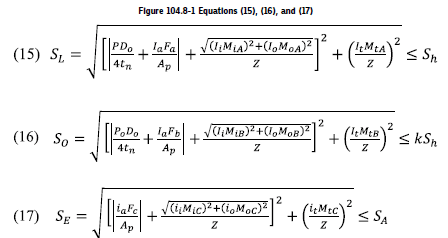

You could use the equations from the B31 codes
@KevinNZ, good information. This is not there in 2018 edition.
@SiggiN(OP) this formula (Fig 104.8-1 above) may be useful. But it is the responsibility of designer to calculate all the possible stresses (Ref Cl. 104.8, first para) and combine the stresses to compare with code allowable limits. So it is to be checked whether all the possible load stresses are covered in the above B 31.1 formulae.
