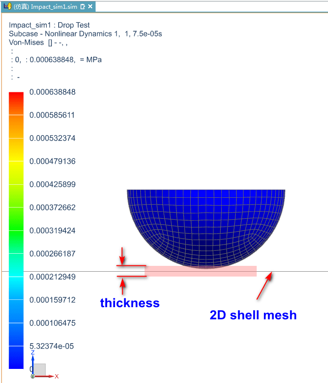

Hi All,
Can someone tell me how to display the thickness of a 2D shell mesh in NX Nastran post-processing?
Any help would be appreciated. Thanks.
Frank

Hi Thomas,
Sorry for the confusion.
I mean to display a 2D shell mesh like a 3D body with its actual thickness. Is it doable?

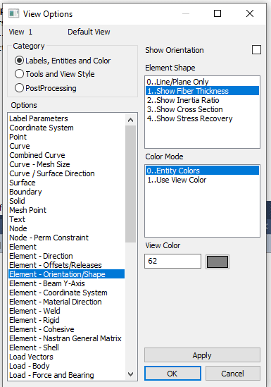

Hi again
If you are working with Femap, try View - Options - Element Orientation Shape - Show Fiber Thickness.
I suppose it may be Femap you are using [smile].
Thomas

Currently, I'm using Simcenter. And I'm going to study Femap.
in SimCenter, for the 2d mesh collector of interest: Edit Display, tick the 2D display option
Thanks, JBlack68
It works only in pre-processing. I can't find this option in post-processing when I check the result.
