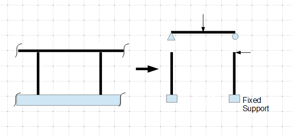

The 200 lbs is a single load that can occur at any point along the top rail. The rail must be able to resist that load when applied at any point, but if the post spacing is the same everywhere, the critical location will be at the midspan of the end spacing (between the 1st and 2nd posts). It can also occur at a post, and the post must be able to resist the 200 lbs and the moment it produces at the base.

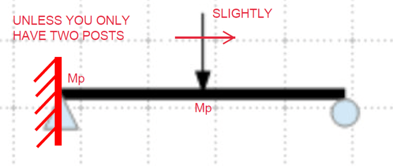

The 200lbs can be applied to the post and for the rail, I apply the 200lbs to mid span and use PL/6 to accommodate the end span... for interior spans the Mp = PL/8. I also use the plastic section modulus Z. I don't think any additional loading is concurrent.
I agree that the load need not be applied concurrently in both directions. The lateral load will always govern the design of the items from my experience.
The actual number is about 5.8...
BridgeSmith nailed it with: "The 200 lbs is a single load that can occur at any point along the top rail." This answers the OP's question directly. The load may be horizontal or vertical - you have to check both. It can be anywhere so you have to find the worst case.
Cassidy,
You shall learn how to simplify a structure, and always look for the loading case that produces the most critical reactions in the simplified structure.
Slightly improved... and Mp = P x L / 5.8
You just couldn't get out of the hall (hole) of plastic design !:) Now the OP is confused again.
