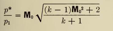

To be theoretically correct the following should be the procedure (air is used)(Ref Streeter)
1. You know friction factor, f, length, l, and dia, D, inlet Mach No M_0
2. Calculate Mach No M at distance l using(Use software like Matlab/Mathcad)
4. For sonic flow at outlet (M=1,hypothetical) calculate the outlet pressure p^*. P_1 is inlet pressure.
5. Calculate p' with inlet Mach no M as calculated.
6. Pressure drop is
RE: Pressure drop in compressible flow
With the given data and Streeter compressible flow formulae I got 0.2248 bar pressure drop. Quite close to results calculated earlier.
