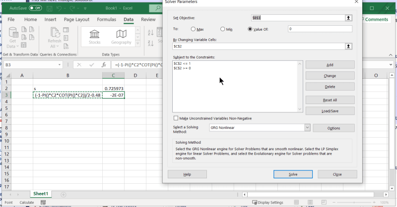

How do I enter the following into an integration calculator to solve for s?
Sum(n= 0 to infinity, s^2/(n^2-s^2)) when the sum value has a known value (i.e. sum() = 0.40348)

Try Sum[s^2/(n^2 - s^2), {n, 0, Infinity}]=0.48
You get the answer in this form:
1/2 (-π s cot(π s) - 1) = 0.48
Rewrite as below and put it back in WA:
(-1 - Pi s Cot[Pi s])/2 - 0.48=0
This will have multiple solutions.
Alternatively let Wolfram give you a couple of solutions like this: Link.

Re-entering the original formula in the form suggested by WA provides several solutions one of which is the one I want (i.e. 0 < s < 1)
Is there a way to limit the range for s within the WA input?

try
Code:
solve (-1 - Pi s Cot[Pi s])/2 - 0.48=0 for s>0, s<1
Or in Excel:
Doug Jenkins

Can anyone suggest a way to solve directly from the original formula in Excel via macro?
i.e. Sum[s^2/(n^2 - s^2), {n, 1, Infinity}]=0.40435 for s>0, s<1
Note that I need to run this calculation multiple times for various values of = 0.40438 and thne again with a slightly different formula and then run this for various values of the function.
i.e. Sum[s/(n^2 - s^2), {n, 1, Infinity}]=0.56037 for s>0, s<1

petb and IDS already showed how that could be done
If
Sum[s^2/(n^2 - s^2), {n, 0, Infinity}] = C​
Then
(-1 - Pi s Cot[Pi s])/2 = C​
