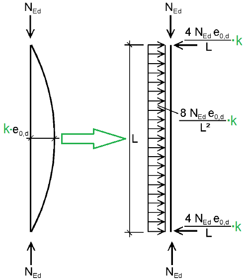

For simple beam structures you may replace imperfections with distributed and concentrated loads. Then you need only one nonlinear solution.
Here is picture from Eurocode 3.

My problem is that I am not working with a simple beam structure. And I would like to do this inside Femap/Nastran within a single model.

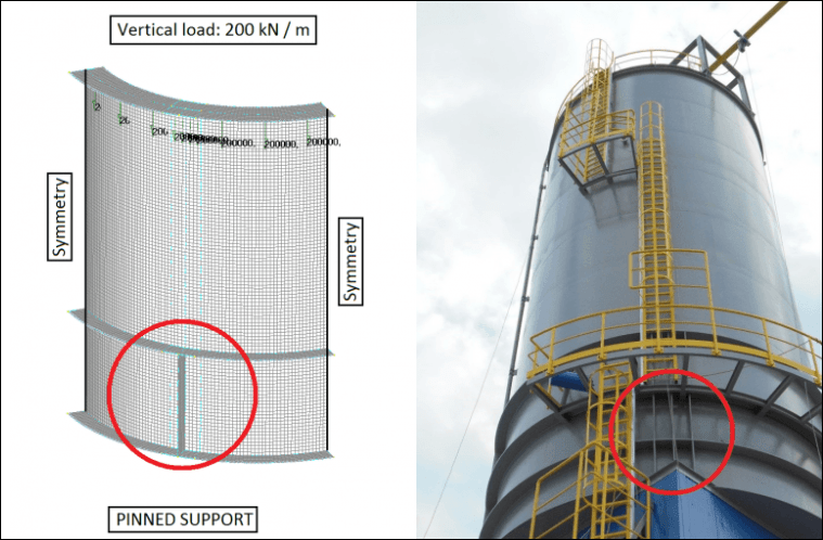

Take a look to the blog of my friend Lukasz from Poland, he is an expert in Nonlinear Analysis with FEMAP and Simcenter Nastran, and he explain how to apply imperfections and solve the buckling problem:
He say: "Using deformations from linear buckling as imperfections in nonlinear buckling case is the most common approach. I will use a simple example to prove that this is not always the best idea. Proper selection of imperfections is a very complicated process – I hope to shed some light on this matter."

The main problem - you need some API to automate this operations. The only way to move nodes to create imperfections (without any additional steps like additional loads) is to use Custom Tools-> PostProcessing->Node Move by Deform with option. This is possible only inside Femap GUI.
