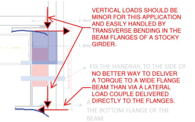

Here is a screenshot of a typical section. I am not going to design the handrail posts or fixings but I have to comment on the design intention. The architect shows fixings to the top and bottom flange with angles, I don't think that this is a sufficient bottom fixing connection as it transfer the loads just at one side of the flange. I show with a sketch that the balustrade panel needs to be fixed to the side of the beam web.
Any comments will be much appreciated.
ps. the horizontal bracing span from side beam to side beam. I just noticed in the upload sketch that this is not shown!

Without a plan detail we don't get enough of a picture. But it looks like there is nothing to worry about.
That secondary beam looks likely to provide sufficient stiffness. Not to mention the size of the primary beams should mean decent torsion resistance. How about you just run the calculation? It shouldn't be that hard. Deflection should be your primary criteria.
I design lightweight walkway gantries all the time. The torsion from handrail is rarely something that is an issue. Generally perpendicular secondary beams will provide enough torsional stiffness. For short spans the end restraints provide enough stiffness.

Top flange:
This is restrained by the horizontal in my view (which is part of the bracing system)
Bottom Flange:
Why not just do a small diagonal fly brace from bottom flange to the horizontal member. This horizontal member presumably being part of the bracing which resolves the force.
Just my take... The W section could be coped and raised to U/S of deck and tubes could be eliminated (helps with stiffness). I don't know what the spacing of the beams are. Deck is spanning the wrong way to stiffen floor and guardrails. Connection plate (if that's what it is) should be raised to be in line with beam flange to minimise moment on post and to provide more stiffness... Deck should bear on beam flange, not angle... maybe a thicker deck or topping to eliminate the X-bracing... other than that looks OK. Are the clip angles top and bottom to support guardrail post? 12m span may be prone to some vibration if lots of people...
I feel that the architect's proposal has merit. See the sketch below. The architect's proposal also may be advantageous in that it separates the guardrail and infill beam connections such that you'd never have to worry about one of them interfering with the other if the spacings are not coordinated.
I like to connect the balustrade to the web, but on a full/partial depth stiffener, instead of your detail. The angles can be eliminated too.
Better to connect directly through the web and line up with smaller beams, and no torque transferred to the large W sections...

Yes, it's better structurally but only if the stanchions actually line up with the infill beams. Generally, I'd not assume that to be the case. This is precisely what I was speaking to previously with this statement.
It is in sense of shear delivering, web connection is more stable than tip of flanges.
Right, but as I mentioned in my previous post, the shear demand will be negligible and it is the moment demand that is critical. In strategically designing the connection, we need to remain cognizant of the particular application.
It may well be that the upper angle is needed as some kind of kick plate anyhow. If so, we might as well use it for supporting the guard.
That's the way I build them... then they line up... If not, it's still easier to accommodate torsion and the span for the deck may be 5' or 6' or 10' with 3" deck... too many ifs... and deck support can be C sections and the plate still works...
1) I'm pretty sure that this is bar grate deck application, not corrugated steel and concrete. So your infill beams are unlikely to be spaced at 10'.
2) If the proposed stanchion stiffeners don't line up with the infill beams then they won't help meaningfully with beam torsion. That they might is a common misconception.
