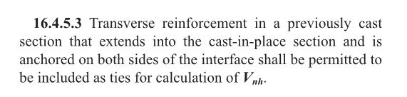

1) The vertical and horizontal shear demands are not additive with respect to the stirrups. This can be easily demonstrated from first principles and we can get into that if you wish. You may have seen me sketch out the FBD in past threads.
2) I believe that ACI 318-19 implies this in a rather soft way in the provision shown below.
