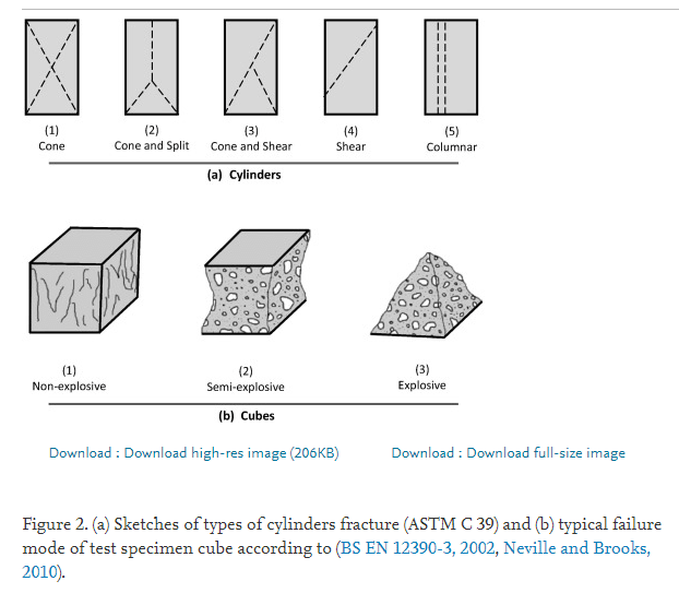

You probably cannot do cylinder strength tests on it as cylinders do no work with grout (fail in shear not compression), you will have to do cube tests and convert the values. Depending on the strength, the conversion is about cylinder = .8 cube.
That's a cylinder test can tell - fail in shear prior to compression (cone or crumbling).
