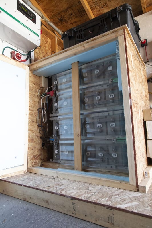

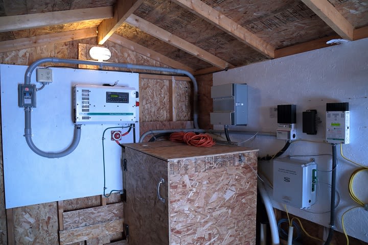

And... large batteries of any chemistry do not belong in living spaces. My VRLA battery shed:
