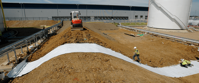

Like this
2m high is actually fairly low - I've seen 5m in my time.
But the picture you have posted seems 2.0 m high dike. The dike ht should be decided acc.to availability of area, fill material etc.. The info. that i provided from ARAMCO standard dwg.
Are you having a laugh?
That's a full grown man (~1.8m), not a small child trying to run up the slope.
That digger is probably over 2m high for scale as well.
I would easily put that bund at 5m high from the floor of the bund.
