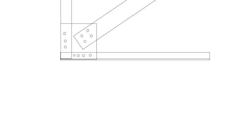

If I use a holddown with cold formed steel diagonal straps, there will be uplift and shear. The holddown schedules from Simpson only show tension/uplift capacity, not shear. How do I know if the shear is okay?
Wood is different because the plywood shear wall will take the shear and transfer it into the bottom plate, which can transfer it into the foundation with anchor bolts. I called Simpson about this but got bounced around between different "experts" so I'd rather ask here.

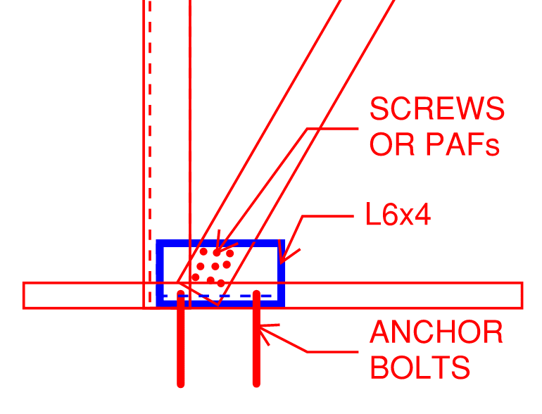

There is no lateral capacity. You have to get the load into the bottom track somehow. I usually use an MC6x18 or an L6x4x5/16 with (2) anchor bolts to resist both components of the strap tension. Welding is required.
If the loads are not high, the Simpson hold-down and a heavy gage, deep leg bottom track can also work.
Check out The Steel Network. They likely have a better solution than Simpson.
@XR250 Thanks! I will figure out a way to transfer the load into the bottom track. And I have a bad history with The Steel Network due to price, but I'll definitely check it out.
@XR250 Again thanks for your response. Sorry if I'm being rude but can you send a picture of your detail? I've been trying to figure out how to get high loading into the track with an MC6 or L6x4 like you mentioned but I'm stuck. I can't figure out the load path because first the load goes into the post.
milkshakelake - I typically detail a plate or heavy sheet to accomplish it. It acts like a gusset in structural steel, but because the members tend to be so much more flexible the horizontal reaction at the stud approaches zero pretty quick.
@phamENG I try to avoid a gusset plate sheet and instead, I go into the stud/post directly. But if this is the only way to transfer the horizontal reaction, then it has to be done. Thanks for the sketch!
Our firm has moved towards steel sheet (sheathing) instead of straps. I know that doesn't answer your question, OP, but this is one of the reasons. I've never seen a blockout in the foundation wall to embed the post into. The guys above are right - any regular hold down isn't rated for shear. TSN has a solution (photo 1) that's essentially a baseplate that is stiff enough to load the anchor bolts in shear and tension, which you'd then design the anchorage just like any braced frame column anchorage. The method you're proposing would put the holddown-to-stud screws in tension and shear depending on the orientation of the hold down relative to the stud/strap, which I wouldn't count on the contractor to get right. Not sure I'd try that. You really need to get the shear into the track like Pham is talking about. I think XR's angle would be installed with a couple bolts into the foundation and the strap fastened to the angle and not into the stud (photo 2).
@dold Nice! Thanks for sharing; I'll probably move to this detail. And I agree that I've never seen a blockout. Simpson shouldn't be showing the flat strap with holddown detail in their catalog since it doesn't work.

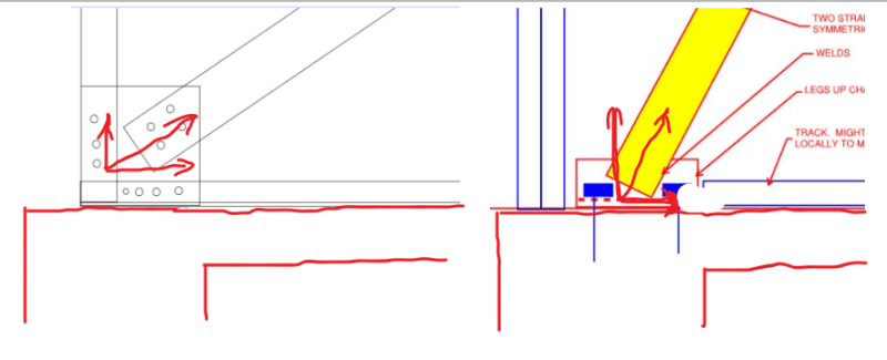

I was able to coax XR's clever detail out of him some time ago. I very much favor the symmetry of the channel version shown below.

I've always viewed this as a double edge sword. If the brace load is delivered concentrically then, yes, the fact that none of the members involved are worth a damn for resisting bending will have the advantage of steering the load components where we want them to go. On the other hand, if the load delivery is not concentric, then you're stuck with a moment that has to be resisted by at least one of the members which is worthless for bending. I'd be interested to hear others' feelings on whether or not it's reasonable to expect the gussets to produce a concentric load delivery. I'd imagine that we'd all feel more comfortable with it when the assembly is done pre-fab in a shop environment.
This is another thing that I view as a benefit of XR's detail: it's quite insensitive to where the brace work point lands.
Another thing about using a gusset between track and stud - this creates a fixity and induces weak axis bending in the chord studs as story drift occurs.

The connection between the strap and angle doesn't necessarily have to be welds for smaller projects. Screws are okay according to the Marinoware (cold formed steel supplier) and PAFs are okay according to Hilti catalog.
For your detail, how come you clipped the bottom track instead of extending it? That way, we can transfer the shear into the bottom track as XR250 suggested.

1) I was just trying to acknowledge that, for some channel / track combos, the track might have to be clipped to accomplish the welding or screwing AND;
2) One of the prime benefits of the detail is that it delivers the base shear straight into the foundation element without involving the track. Shoving monster amounts of thrust into bent tin isn't the greatest of load path arrangements in my opinion.
@KootK Thanks! I totally agree. If we can get the shear done in that channel or angle, then it's a done deal. No need to transfer it into the bottom track as others have suggested.

Thanks r13 for the new opinion. I think I'll stick to the angle idea on the right side. I don't trust contractors to do a good sheet steel gusset plate like on the left side.
My issue with the gusset plate is that you are assuming that the vertical force component is managed by jamb and the horizontal force component is managed by the track. I think that if it were a very stiff gusset plate compared to the resisting members, that may be the case. However, I beieive in reality, it acts more like a membrane and will pull the jamb sideways and the track upwards - In which case the weak axis strength of these members would come into question. My experience is that it would be difficult for these to pass. If someone can disprove this, please do.
The track and the jamb shall be fastened to the foundation, though it is not shown on the sketch. The right hand side method seems more strong by fasten the strap directly to the foundation, but in doing so, you need to enlarge the footing, and deal with the eccentricity between the strap connection and the jamb. So it is a choice of preference rather than other matters.
@r13 I don't think I'll enlarge the footing that much. Let's say I have the ASD maximum capacity uplift. For a 6" wide 12 gage strap on one side only, that is approximately 0.6 x 50 ksi x 0.097 = 2.91 kips tension. If I have straps on both sides, it'll be 6 kips. That's not a large load, even for cold formed steel. It will affect the connections more than the footing.
