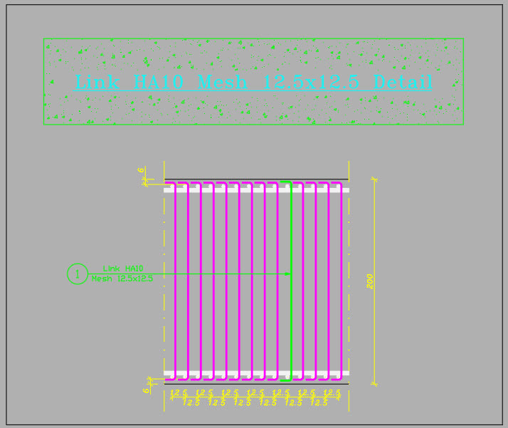

Actually , our case that the raft foundation slab thickness (2000mm) and there is no possibility to increase the raft slab thickness at the column locations snice the basement height level is very limited . So, we have used the shear reinforcement to increase the raft foundation capacity as mentioned in your attached reference -- (standee bars) to resist the beam / punching shear .

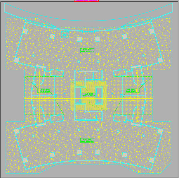

I could not see the reason why you can not increase the slab thickness... The mat thick . could be thicker where necessary keeping the top level of mat constant. There are a lot of examples and one is ; ( Froum bldg complex Frankfurt ). This snap is taken from J.A.HEMSLEY
You provided 10 mm dia links with 125 mm dist. both ways ..If this is true, i will suggest to ask the services of an experienced structural engineer rather than looking for an answer from a web forum.

1.I think your capture shows ( piled raft foundation ) and the raft thickness has been increased at the pile locations to resist the two way shear from two sides of foundation ( top &bottom) .
Whiles our issue regarding to raft foundation supported on soil . my doubts was about using reinforcement to resist the shear forces .

The thickness increase is not due to piled foundation. The same concept is used for rafts directly supported on soil. Here is another picture... May be you have seen Al Faisaliah Tower Riyadh , 40 storey bldg.
10 mm links can not provide support to top reinforcement. You should use chair with increased dia or better use steel profile . I will suggest you increase the thickness under the cores or choose higher strength conc. ( as proposed retired 13) rather than providing punching reinforcement.
