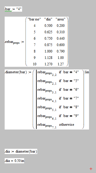

This value must be a scalar or a matrix
GC_Hopi
Jun 24, 2018
556
Having the following issue when writing a function in Mathcad.
Thanks Greg. I got it working by moving the dimension out side of the programing line. It must be something with the Mathcad version...it was working with the old version the way I had it in the first post.
the subscripts seem off
could you use the variable bar as a subscript
you can also use .dia := diameter(bar) = and it should show 0.50in after the + sign
It would be easier not to use functions, but only array index. See below in MathCad prime, could be done similar in 15
