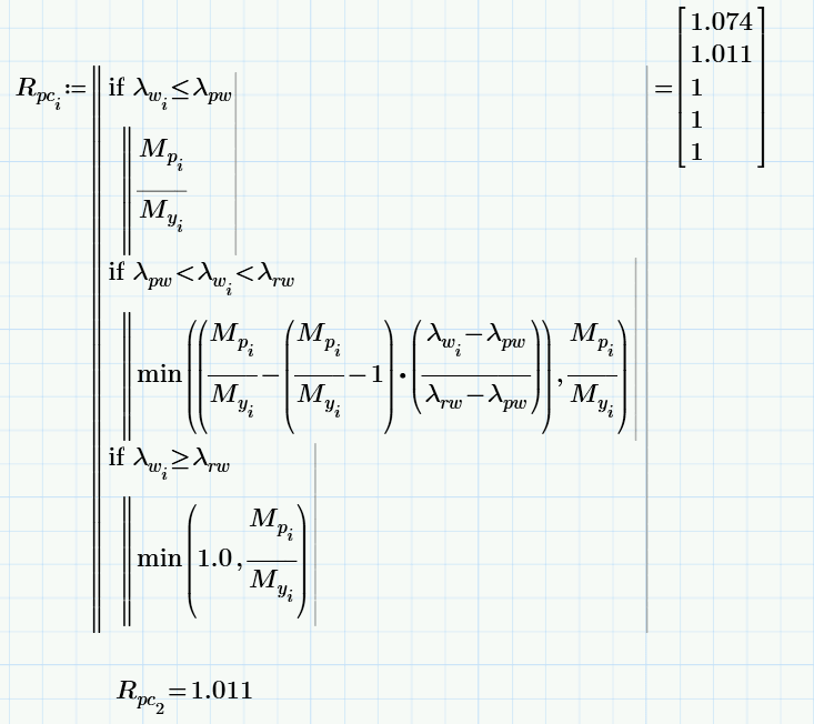

Please find the attached image:
I'm not aware how this could be solved.
Any help would be highly appreciated.
Hi, I'm sorry if I haven't been clear.
I meant the inclusion of the R_pc2<=M_p2/M_y2 condition into the If statement. How this can be done?

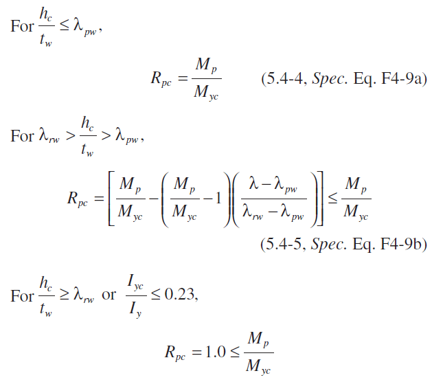

So, you're checking Rpc2 to see if it's less than the ratio between its plastic moment and yield moment (the shape factor, if I recall correctly).
So, what happens if Rpc2 exceeds that ratio? I assume you need to check all your Rpc values against the moment ratio?

Thanks, if Rpc2 exceeds that ratio, then R_pc2=M_p2/M_y2.
It appears to me that you're already (essentially) doing that check with your first statement.
UNLESS, is there ever a case where lambdaw is less than lambdarw, but you could still end up with a value that is greater than your Mp/My? If the answer to this is "no", then you don't need to perform the check separately.
Please find the attached image for more clarification.
P.S
Lambda_w=h_c/t_w

if that is correct you can use the max(1.0,Mp/Myc) in the last statement to force this to work.
Hi structSU10,
Thanks. Should it be max or min function?
Please find the attached image. Am I doing it correctly?
I think it is min in this case as you are limiting the left side of the inequality to be less than or equal to the right side.
