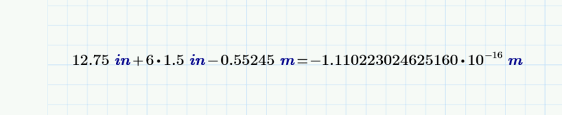

When I open a blank instance of MathCAD Prime 6.0.0.0, and I evaluate the following equation, it evaluates as false. When I remove the units it evaluates as true. What is happening and why do the units impact this?
12.75 in + 6*1.5 in = 21.75 in ---- This evaluates as false.
12.75 + 6*1.5 = 21.75 ------------- This evaluates as true.
12.75 + 6*1.5 does equal 21.75.
Note that I am using the Comparison version of the equals sign (CTRL =).
Any help is appreciated! Thanks!

That will be numerical round-off error.
All Mathcad units are converted to SI prior to evaluation, and a small amount of round-off error can be accumulated in the process. As an example - try evaluating:
12.75 in + 6 * 1.5 in - 21.75 in
This should yield precisely zero mm (or inches), but my copy of Prime 2.0 says it is -1.11E-16 metres.
It's always risky to evaluate a numerical result using exact equality; you really need to set up a test for "close enough to being equal" - where what is "close enough" will depend on your application.
In the evaluation above , the error is about 1/10 the diameter of a proton, which would typically be "close enough" for most practical engineering applications. (It is however MUCH bigger than the Planck Length, so could give erroneous results if quantum effects come into play in your distance measurements! [bigsmile] )

Actually, it's still bit odd, since Mathcad 14 shows a zero result, although I think I recall that Mathcad Prime supposedly had additional precision that wasn't displayed.
And that results in the below, even though the conversion to SI units is exact. Mathcad 14 shows zero for the example below

Don't forget that deep down, Mathcad uses binary numbers for storage and calculation. While Mathcad "knows" that one inch is EXACTLY 25.4 mm (only one decimal place in floating point representation is required for exact precision), the binary repræsentation of 25.4 might be something like 11001.011001100110011.... (with an indefinite number of "binary places" - possibly infinite, to get a precise conversion). Numbers are only stored and manipulated to a finite number of binary digits, so round-off at the last binary digit is to be expected.
Note:
1.1102230246...E-16 happens to be the value of the 53rd binary digit (= 1/253) past the "binary decimal point" (1/21, 1/22, 1/23, 1/24, ..., 1/252, 1/253, 1/254, ...), so that is a likely clue as to the nature of the rounding error which is observed.

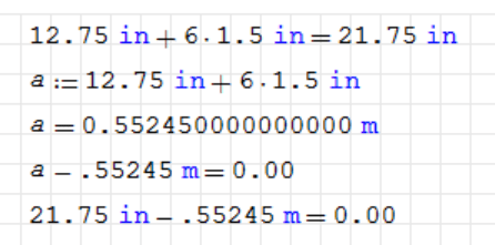

From SMath
SMath uses its own maths "engine", which presumably uses its own algorithms for handling units, round-off precision, and deciding when a very small number is to be taken as "zero".
Note for example that when you add and subtract several dimensioned terms and end up with a zero result, SMath presents the answer as a unitless "0.00". You can append units of mm (or inches etc), to show the result as "0.00 mm", but you can also append any units you like, and have the result shown as "0.00 kg" for example. SMath evaluates a dimensioned value of "zero mm" (for example) as being unitless 0.00, losing the original dimensions of length in the process, and it will report that 0.00 kg is equal to 0.00 mm.
Mathcad Prime is rather more robust than SMath in this respect - a dimensioned expression which results in a zero value will still show the units as "0.0 mm" (or whatever).
SMath will even evaluate an expression with mixed dimensions if one of the mismatching dimensioned terms cancel out; e.g.:
12.75 in + 6*1.5 in - 21.75 in + 6 kg - 2*2.99 kg = 0.02 kg
Mathcad will flag this expression as having incompatible units.
