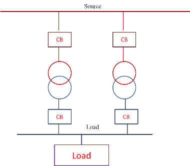

What do you mean with paralleling in this case?
Take into account that paralleling of transformers means that both primary terminals and secondary terminals of the transformers to be paralleled are connected together (primary terminals to the same supply bus and secondary terminals to the same load bus, with corresponding phases), like this:
If you want to connect two transformers to the same supply, but each transformer load is on different buses, then is not a parallel operation and you can do it without a problem.

I've attached a single line of how this setup would look like. I need to supply single phase loads from the single phase transformer, since the three phase unit has a limitation on how much power it can supply to the single loads based on the percentage of its rated kVA. I have an option of feeding each transformer from their own circuit breaker also.

[URL unfurl="true"]https://res.cloudinary.com/engineering-com/image/upload/v1601665344/tips/Parallel_operation_of_xfmrs_xojnb8.pdf[/url]

Never seen a neutral taken out from the middle of a delta phase, is that something common in ANSI world??
For starters, I can see at least one big problem: you connected the primary of the single phase trx to phases B-C, but then the secondary is connected to N (middle of A-C) and C.
With that connection there will be a voltage angle mismatch, as the single phase transformer secondary will be in phase with its primary voltage B-C, but the corresponding connection from the 3ph transformer is in phase with voltage A-C, 120º apart. The N point should be brought out from the secondary B-C winding or the primary of the 1ph trx connected instead to A-C.
EDIT: Addendum in italic.
Good catch.
I missed that.
The primary of the single phase transformer should be fed from A-C
