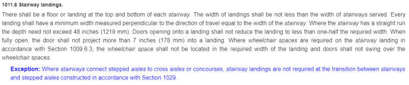

We have a project Power Control Center (PCR)
and we will built the stair & platform at the 3’(W) x 7'(H) exterior door.
So we would like to know what is the minimum length and width of the platform to comply with IBC-2015/ Section 1011.6 building code
when the door is opened onto the landing at 90 degree and the building serves an occupant load of five or less because our building type for storage of the electrical equipment and just have a few technicians/controls guys to monitor.
 https://files.engineering.com/getfile.aspx?folder=b2017b0c-7be8-420b-8198-c01c15e8ee67&file=minimum-landing-dimensions.PNG

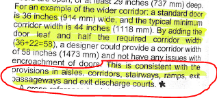

And I'm still have a question regarding to IBC-2015/Figure 1005.2. Based on this figure, do I have to satisfy the highlight condition on the picture below when IBC commentary said that it's also applied to platform as well:
Here is the copy I got from IBC-15/ Section 1020.3 Obstruction:
The intent of the code is to make sure that doors (when opened) do not impede the egress of occupants that may be trying to move past said door. In the images above, the door is opening into a corridor that serves traffic moving past the door in question.

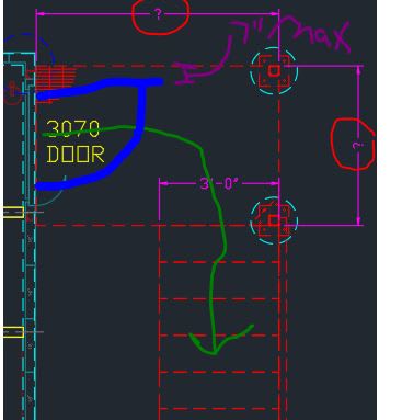

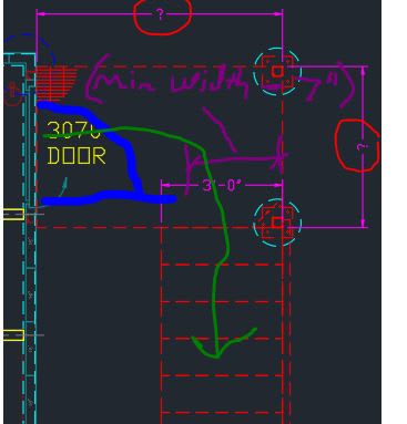

Your situation is different in that the landing only serves the door. If the door swung open so that it was on the same side of the landing as the stair you would need at least the minimum width - 7" (36-7 = 29") so that people are still able to exit the door and move past it down the stairs (egress path shown in green). See image below for this situation:
However, your door should/will open the opposite way so that it will not impede the egress path (shown in green). So, the only requirement is that the door does not stick out more than 7" when open (a typical door won't) as shown below:
The minimum opening requirement that is shown in the first image is not required in the second image as there is no egress path that needs to move past the door.

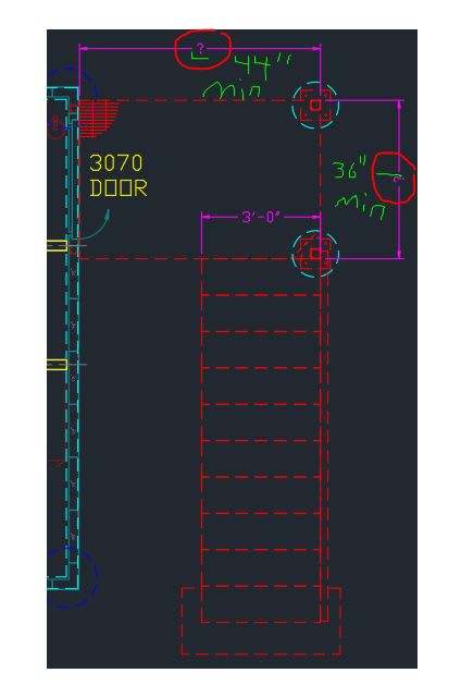

Per section 1010.1.6 the landing width shall not be less than the width of the door or stairway. For your situation, both the door and stair are 36" wide, so the landing needs to be a minimum of 36" wide.
Per section 1010.1.6 the landing must have a length (in direction of travel) of at least 44" - this would be the direction you travel through the door (left to right in your picture).
Per section 1011.6 the landing must be at least as wide as the stairs (left-right direction on your picture), so 36".
Per section 1011.6 the landing must have a minimum depth (defined as parallel to direction of travel on the stairs, top to bottom on your picture) of at least the minimum of 48" or the stairway width, whichever is less - so 36", the stairway width would control
Putting all of the requirements noted above together results in a landing that needs to he a minimum of 44"x36" as shown in the image below:

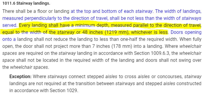

Are you looking on the IBC-2015 Code and Commentary? I attached below from 2015-IBC
My last post was showing what is in the 2018 code - I mistakenly looked at it and that is where the minimum depth requirement I cited came from.
I don't actually see a minimum depth requirement in the 2015 code (in this section), just a statement that it need not exceed 48"
Based on IBC-2015, I will go with 44" minimum depth & width landing to satisfy with both sections listed above for my case (A straight run stairway. Do you agree?
