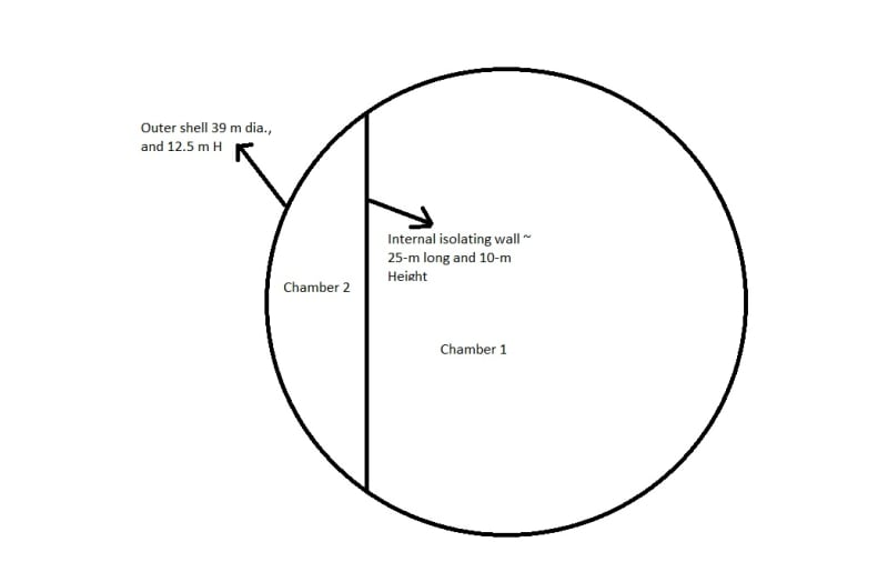

Hi Folks,
We are in process of hydro testing an API 650 tank, cylindrical design, 12.5-m H x 39-m DIA.
The tank has multiple chambers that are isolated from each other, imagine now one big wall of 10-m Height separating the tank into two compartments.
The isolating wall is designed for 10-m water level difference between the two sides, that means it is designed to withstand one side empty, one side full to the 10-m water Height.
Does each compartments (chamber) need to be separately hydro tested for strength verification of the wall splitting them?
API 650 remains silent for any hydro test for internal chambers even if they undergo this high pressure (like in this design) and only asks to check Shell by filling the entire tank and maintain for 24-hr minimum.
Appreciate your thoughts.

Here is the sketch, the wall splitting chamber 1 and 2 is designed for 10-m water level difference and is 10-m High too. Does Chamber 1 or 2 need to be separately hydrotested for the same 10-m high to ensure strength safety of the wall in between? The 10-m water level difference requirement for the wall between chamber 1 and chamber 2 is due to an internal process design condition for this tank.

The dividing wall is hugely reinforced by stiffeners and properly seal welded to the shell that is also locally reinforced to the shell/wall junction because of 10-m water level difference (wall design and junction was verified by FEA). This is not a storage tank, we have a process condition that requires one side be full and one side be empty during operation.
The question is: should this wall design condition be verified by a separate hydro test of each chamber separately, to ensure that the wall can handle 10-m level difference (to validate FEA)?
API does not request for internal walls design hydrotest, we will still do tank full hydro test as mandated by API regardless.

The wall to shell junction on the shell is heavily reinforced for the same reason you raised, as well the wall itself is heavily reinforced, the design is checked/verified by FEA for safe operation at 10-m height level difference.
The question is should the design also be validated by a separate hydro test or no?

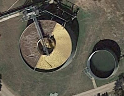

(Edited)- HTURKAK- If I remember right, we built a tank several years back, roughly 75' diameter by 16' high, with inner and outer tank, then two radial partitions between the two. So quite a bit smaller/lower, and the flat wall parts were much shorter. I believe this is it here- won't let me upload the photo directly for some reason:

Dear Mr JStephen , the picture that you have posted implies, clarifier picture (in general RC buried tank ) rather than API ground supported storage tank..

I understand your safety point, I am also of the firm opinion that chambers should be hydro tested separately to ensure the wall design and the wall/shell junction integrity and safety before tanks goes to operation.
Please note this is not a simple storage API tank, it is a process tank and the internal walls inside are for the same reason, we treat water in this tank.
So the design idea was as follow:
API calcs used for shell plates sizing where there is no internal wall welded to shell.
FEA calcs wherever there is an internal wall welded to the shell like the sketch I showed to you (special chamber design).
From FEA we realized that wall to shell junction on the shell plate should be heavily reinforced, so we have added thicker shell plates locally and lateral reinforcement bars from top to bottom inside welded to shell to ensure that end junctions are rigid and will not deform. Stresses and deformations are checked in ANSYS and they pass API allowable stresses under 10-m level difference on each side.
Also the internal wall itself is heavily reinforced by a heavy grid of horizontal and vertical reinforcement bars on the smaller chamber side for the full height of 10-m water difference for its design condition. FEA suggests that stresses and deformations are within API allowable on the wall itself as well.
API and FEA design calcs (in ANSYS) are checked by client and approved.
We have build the tank (not in operation) and we are close to hydrotest and there are discussions on what the procedure of hydrotest should be.
I have suggested API hydro test (whole tank full) as well as hydrotesting each chamber separately with 10-m water level on one side and the other side empty (to follow design condition).
I should check internally and see if I can share more sketches in this public forum for you to understand all the local reinforcements that I explained above.
Based on your comments, I conclude we should do separate hydrotest with all safety measures at site before operating the tank.
