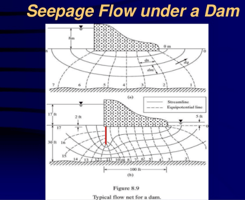

I think you can simplify/focus the quite involved topic to two mean factors - hydraulic head differential, and permeability characteristics of the soil beneath the dam. You can even consider increase student's interests by making a prototype in a fish tank, and add dye to demonstrate the seepage flow.

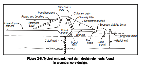

Some pictures.
Vertical clay soil wall of very low permeability is often added to the interior of normal soil and concrete dam structures to prevent through-the-wall seepage when dams are founded on impermeable soils and/or bed rock below. Permeability of normal concrete can be relatively high in itself.
Minimizing seepage in dams seems like a highly specialized topic to present to high school students. They would probably benefit more by teaching them basic principles.
BA
The concept is simple - block the flow passage by impervious core (usually clay core in earth dam), and lengthen the flow channel using seepage cutoff walls. Other important features should be brought to teaching are "piping" under dam, erosion at downstream toe, and preventive measures.
seepage control is not always just blocking the flow, perhaps more important to filter it. so filter diaphragms are maybe just as important
