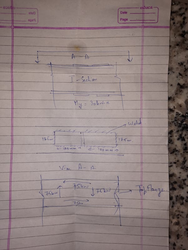

@All
As the minor axis momemt is 30kn-m .It will be divided between the top and bottom flange i.e each flange will resist 15kN-m of load. Thus the force in the flange will be 15/0.2 = 75kN.
Thus force in weld along lengtb 75/200=0.375kN/m
Also i will result in formation of couple like shear .Thus force in weld along width =75/175= 0.428kN/m
Is my understanding correct?
@BARetired As u said it will be added on one side amd subtracted on the other.My understanding is if my top flange in in compression amd due to minor axis moment my one side of flange is in compression and other in tension thus for one side we will be subtracting and for other we will be adding.Is my understanding correct?

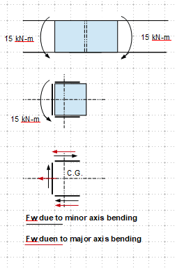

@retired13 So is my understanding correct.Our drawings are matching.
But I have one doubt.When calculating the force for the weld we are adding the major axis bending momemt force to get the critical force for weld.
In case of simple I Builtup beam we design tge weld between web amd flange for only shear force that is acting on the beam and we never consider tge major axis bending moment force for weld calculation.
Why?

Sammy,
In this case, the minor axis bending becomes torsion on the half connection plate, so it is additive to the stress due to major axis bending (Fw = Mx/d), as both resulting in shear in the weld. Note that the shears are to be added together as vectors if they orientate in different direction/axis. Also, do not substract shears in opposite direction, but to use a single weld size for the largest force in the weld lines.
