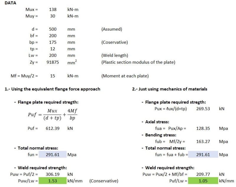

I have got a Beam Splice to design, which has both major and minor Bending Moment (BM). Major BM is 138 kN-m (102 kip-ft), Minor is 30kN-m (22 kip-ft). Please see the snapshot below.
It is taken from RAM Connection Program. The minor BM has been included in the program, but it used only the Major BM.
What I want to know is, the weld shown here for Major BM design, will it be adequate for Minor BM too? or Does it require further checks?

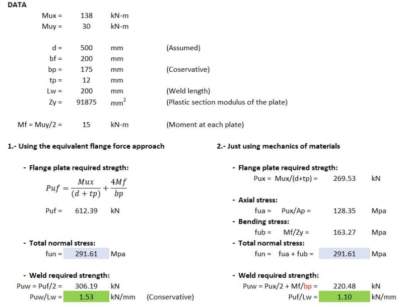

Attached is a comparison between the equivalent flange force approach and a more theoretically correct design model. The plate acting stresses are calculated for comparison purposes only.
Sorry, there is a little errata in the above calculations. The modification is indicated in red...
