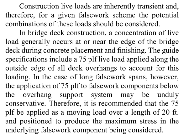

Per the commentary of AASHTO Temporary works, 2nd, C2.3.3.2.1 :
To hopefully add a little clarity to the commentary posted by MIKE_311 above, the 75plf accounts for the weight of the construction workers on the catwalk outside the formwork for the edge of the deck and the screed rail.

I have been told AASHTO requires a 20 psf construction load that I am going to call a floor live load. Slide's post above also noted the 20 psf floor live. For me, while 20 psf floor live is probably sufficient when you have plenty of "elbow" room, it seems to small for cramped quarters such as this.
I was also told that some brackets are designed for a 50 psf floor live load although the post above notes an AASHTO 20 psf construction load. I generally run the floor live load all the way to the edge of the support arm. Wouldn't the worker shown on the right side of that picture be included in the 20/50 psf floor live load or is the 20/50 psf floor live not intended to extend beyond the edge of concrete?
