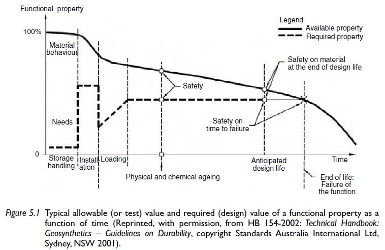

Your question reminds me of liner design life versus strength see image below. My understanding of soil nails is that the nails degrade over time so the thickness and spacing is determined by the expected strength at the end of the design life.
PEInc, thank you for correcting me. I do have a follow up question regarding the service life of soil nail walls for permanent walls or reinforcement. The new global tailings standard requires facilities to be designed to 1 in 10,000 year seismic and flood events if they are to put in a state of passive closure. Is the service life of permanent soil nails or ground anchors applicable to a site where after a period of monitoring the intent is for the owner to walk away from the property and let nature take over?
I don't know what all of that means. However, various agencies may specify a design life of an anchored wall, usually 50 or 100 years. This would apply to corrosion of steel members. I never saw anyone worry about longevity except for the ground anchors and their hardware. Therefore, the anchors and hardware are protected by some combination of grout, concrete, plastic encapsulation, grease, or coatings such as epoxy or HDG.
