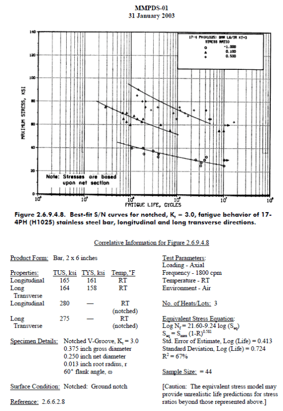

I am trying to find an S-N curve and/or the strain-life curve of 17-4ph h1025.

MMPDS would be the best source.
Caution, with 17-4PH the actual strength, original material size, and sample orientation are all important.
So how the material was made. Most 17-4PH is air melted, but it is available as re-melted product that has much higher toughness and fatigue properties (especially transverse).
The toughness and fatigue properties of 17-4PH start dropping off above 1" thick, and tank above about 4" (this is why 15-5PH exists).

So what is the item? You need to know the size and shape, as well as how it was formed from the raw material, and what size that was.
This is an alloy that for aerospace work prohibits the cutting of plate to make bar. With plate you have three directions; L - longitudinal, this is the rolling direction; T - transverse (more accurately LT long transverse) which is the width of the plate; and ST - short traverse, which is the thickness.
If they started with a thick piece of stock and machined a smaller part of of it then both orientation and location within the raw material could play a roll.
The toughness and fatigue properties will be descending in that order as well.

Below are S-N curves from MMPDS for notched 17-4 PH cond H1025 bar, which may differ from your case. These curves are for AMS 5643 which is air melt quality material. AMS 5622 is a vacuum melt quality form of the same material, and would have better fatigue performance as EdStainless noted.
Hope that helps.
Thsnks tbuelna thanks for the help. This graph shows results with stress concentration 3. Can you please suggest me how I use this for fatigue analysis? Ideally I believe I need fatigue test results of test done without notch so no stress concentration.
