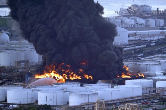

The Chemical Safety Board has released an updated animated video on or about the 15th anniversary of the BP Texas City refinery 2005 explosion and fire.
An ad for CSB's forthcomin interactive training application takes up the first 40 odd seconds of the video. The animated narrative starts at 00:43.
The animation is quite realistic, including a coffee mug stain in the control room log book. It's just like you're there on-site or watching it unfold from a drone. Gives me the shivers.

Believe there is at least one important contributor to this incident at BP refinery in Texas that wasnt pointed out in this CSB video, which is a basic process design flaw: The safety valves on the isom unit splitter tower ovhd line at the base of the tower lifted prematurely at below setpoint pressure at the tower top. That was because the set point was set at design pressure and was not designed to handle a liquid release which contributed some several bars of static head since the tower was liquid full. Hence when the PSVs' lifted at SP, pressure at tower top was well below SP. Those 3 safety valves should have been installed at the top of the ovhd line, not at the bottom.
Sounds like there was flow instability in the transfer line from the isom unit reboiler back to the tower, which may explain why these operators habitually overfilled the tower bottoms sump on startup - thermosyphon reboiler?? Another cost driven design approach which compromises operational flexibility??
