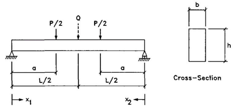

Hello,
I need to determine the max deflection of a FRP (fiberglass-reinforced plastic) stair tread subjected to two point loads. Here below a picture which illustrates loads and dimensions:
Does anyone know any formula to calculate the deflection (assumed to be at the center of tread)? Since FRP is anysotropic, to simplify the problem we can assume it as 2 point loads exerced on a simply supported beam.
Any advice is welcome
Cheers

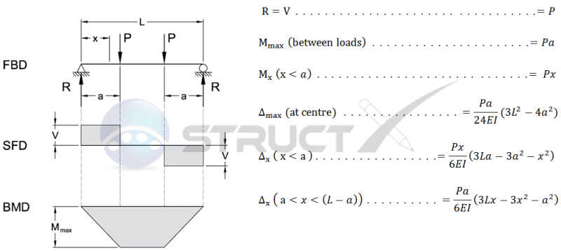

You want to use superposition for two cases, one for each point load. Or a quick Google search gives this:
Depending on the material properties, shear deflections might also be important

Hi Lo,
thanks for your quick reply. I came across the same calculator on structx.com. Unlike steel, shear deflections shall be calculated for this material. Do you have any formula that takes into account both bending and shear moments for this particular load?

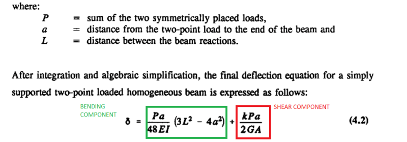

I have found this online:
The question the arises: why is the bending component different from the one shown on Structx.com?
RE: Two Point Loads on Stair Treads
Sorry I found the answer by myself:
They considered half the load for the equation.
