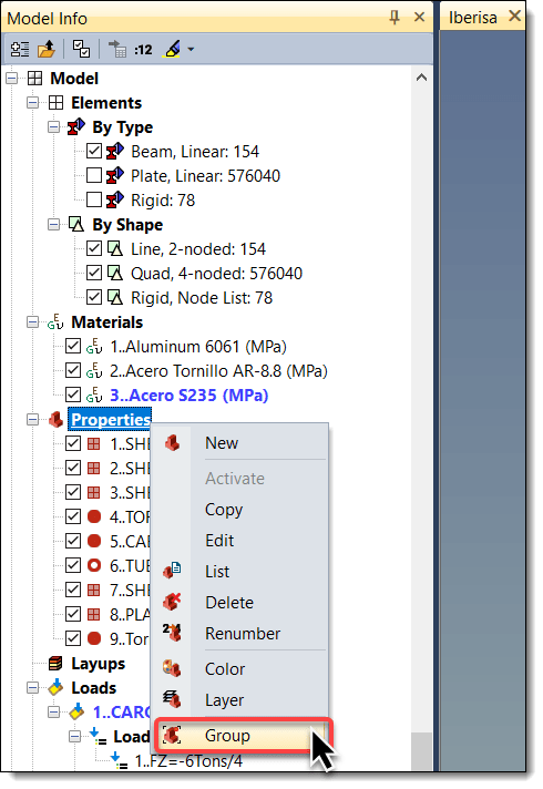

GROUPS in FEMAP is very powerful, I use it a lot, specially for postprocessing.
You have a menu to create groups.
Also in the MODEL INFO tree you can click with the right mouse button (RMB) in say PROPERTIES then select GROUP and FEMAP will create different groups with elements for every property:

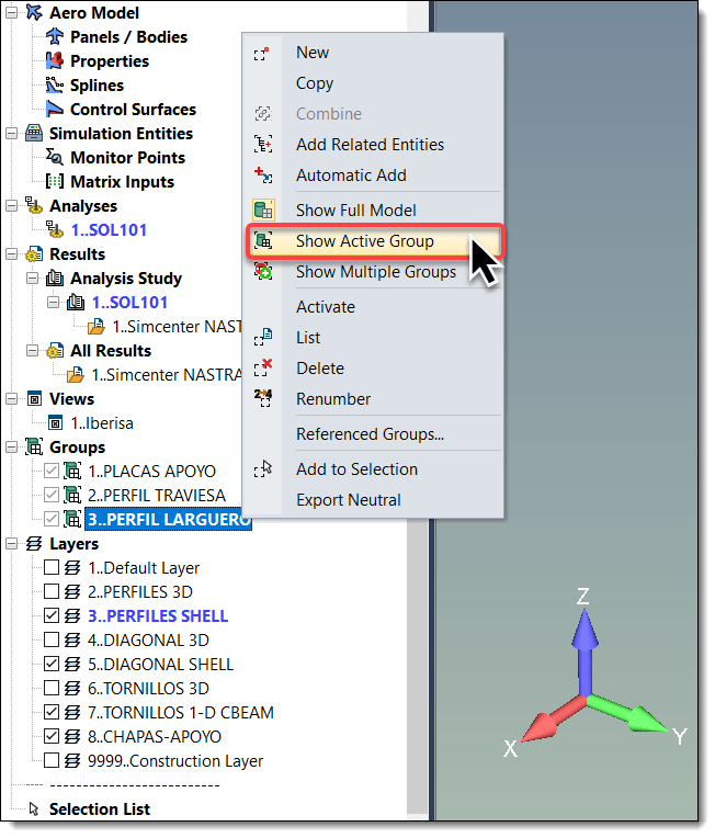

All your groups will appear in the MODEL INFO tree under GROUPS: to postprocess results in the elements of the group simply RMB in the group and select SHOW ACTIVE GROUP: from now in advance when you plot any output vector like vonMises stress in elements only the results for the elements of the active group will appear in the screen. And is more: the legend of results will be limited to the values of the active group, not the full model.
To return to the full model click in GROUPS and select SHOW FULL MODEL

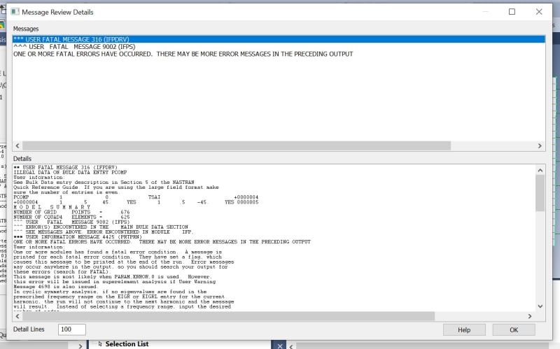

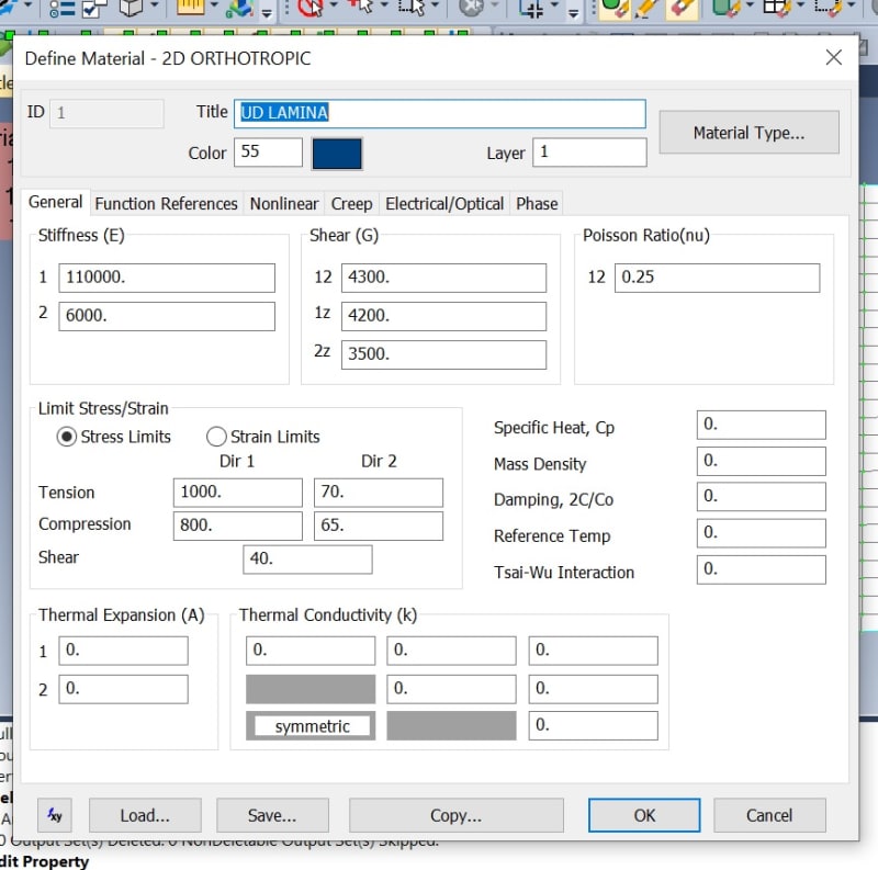

I am trying to model the composite laminate, I can get the stiffness's fine but when I enter the stress limit values, and failure type, and run the model, the error message comes up. Do know how I could fix it ?
Sorry for asking too many questions here
What version of Femap are you using?

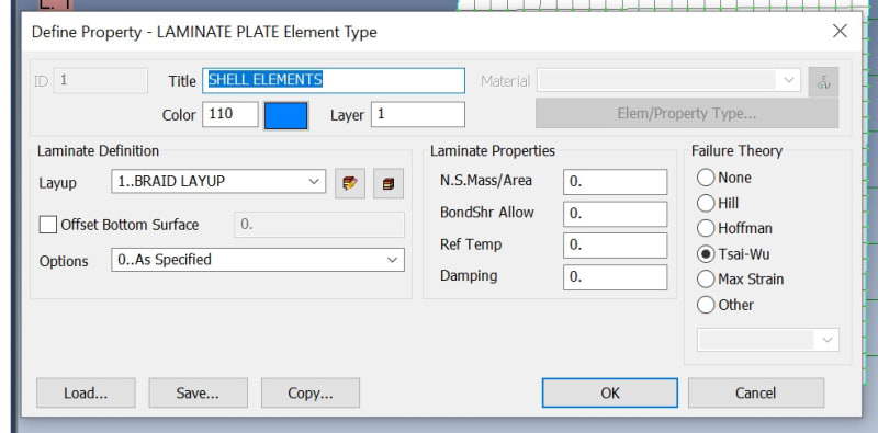

In your laminate property, do you have the "Failure Theory" set and also the "BondShr Allow" set?
Are you getting an error right when you analyze or preview the deck? What does the error say?
Hi, I am using FEMAP 2020 version. I set the laminate property in the element stage, but the analysis produces errors such as
I even checked the material orientations but it still shows me the same errors. I dont have the bondshr values,
Could you advice ?
thanks in advance

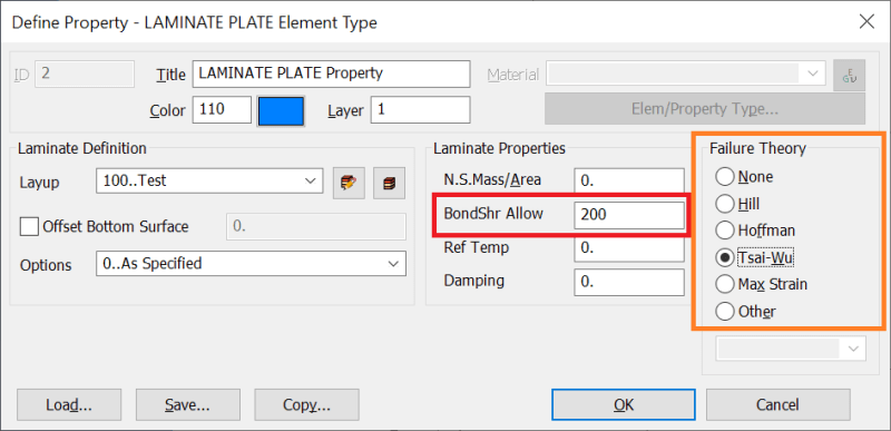

You must enter a "BondShr Allow" in the laminate property dialog if there is a Failure Theory specified. In the Nastran quick reference guide (QRG) it states for PCOMP: "SB - Allowable shear stress of the bonding material (allowable interlaminar shear stress). Required if FT is specified. (Real > 0.0)"
