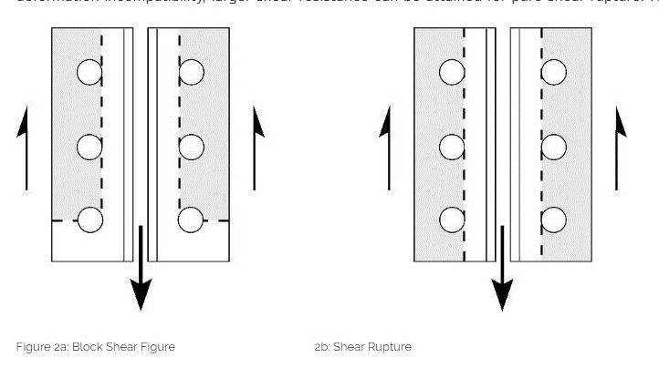

Quick question: My effective net area for tension would be horizontal and vertical for shear, right?? How does that work where they overlap?
Can you post a sketch of an example? I'm having difficulty visualizing the scenario that you've described.
@KootK in the picture you posted, Figure 2a shows the white area. It "overlaps" at the corner. Does that mean net areas are calculated differently?
@KootK, nevermind. I had a brain fart lol the net areas are based on the plate left afterward. sorry.
If you don't have tension, your net area will be just the length of the angle leg minus the sum of diameter of bolt holes.
@cliff234 This may be too much to ask, but can you upload a sketch of what the coped beam would look in block shear rupture? I visualize looking exactly like figure 2a in the picture above. Is that correct?

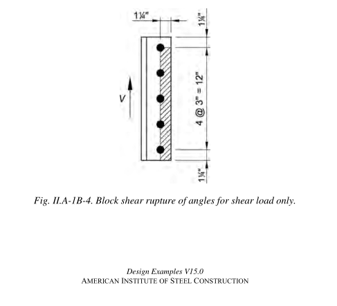

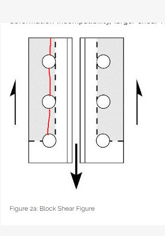

not to complicate things but I've always seen figure 2a from KootK's post with the shear line thru the bolt center line, as it's drawn in their figure you'd potentially get more Anv.
From AISC v15.1 Examples:
To clarify my question above, if my connector angle is centered on the web of my channel, would it still look like the picture attached? or would it not tear all the way to the top of the web and instead stop at the plate???
I know this question is very confusing.

@celt83, yes I used the centerline through the bolt holes.

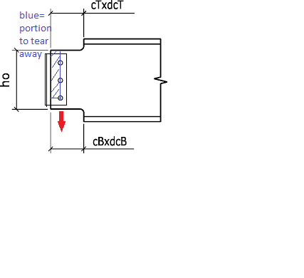

Also, I'm tryng to sketch it but it doesn't make sense. Let me sketch and upload my best shot at it. Brb
Please see the attached sketch. the blue is what I believe will tear away with the connector angle placed in the center of the beam web.
Yay! Thanks so much @Celt83!! Thanks to everyone on this thread. I was overcomplicating a very simple task.
