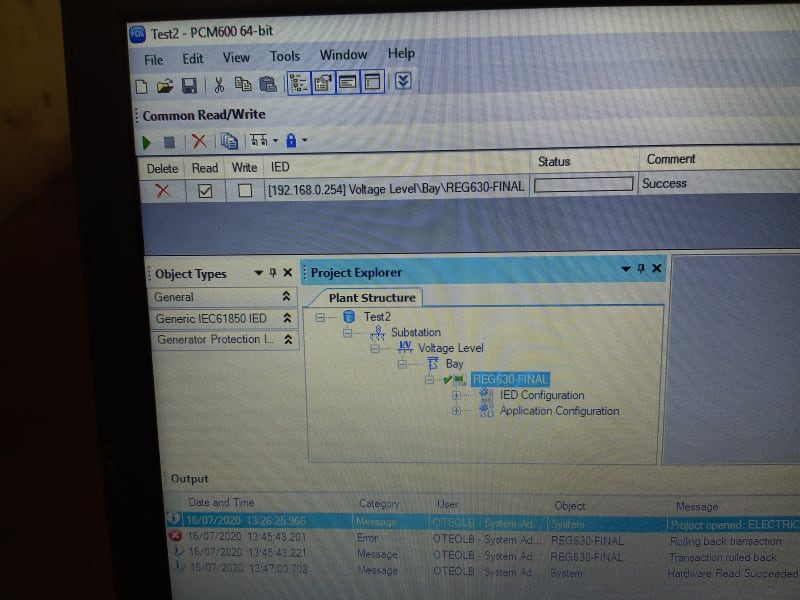

I have been able to communicate with the relay ABB REG630. Thks a lot.

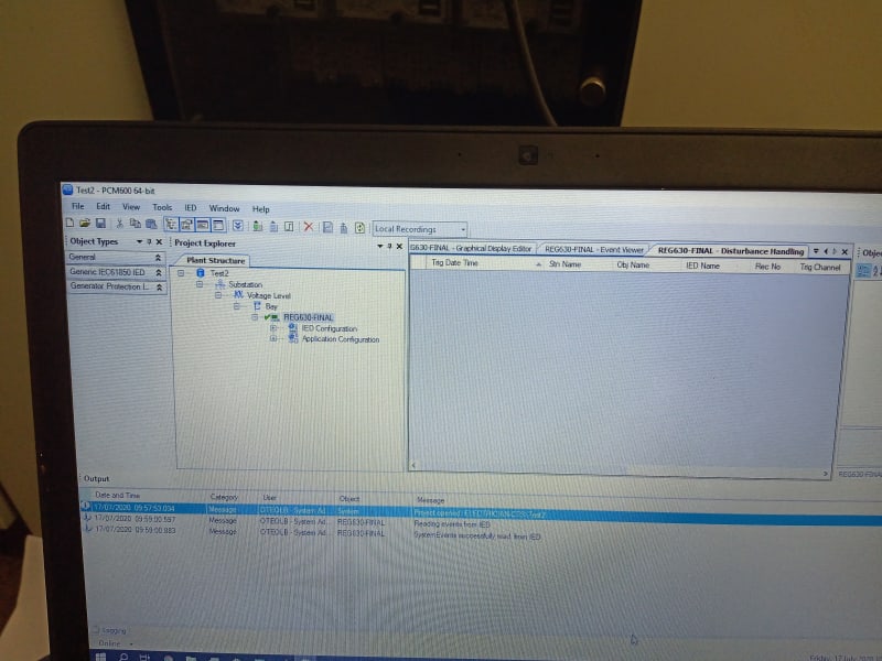

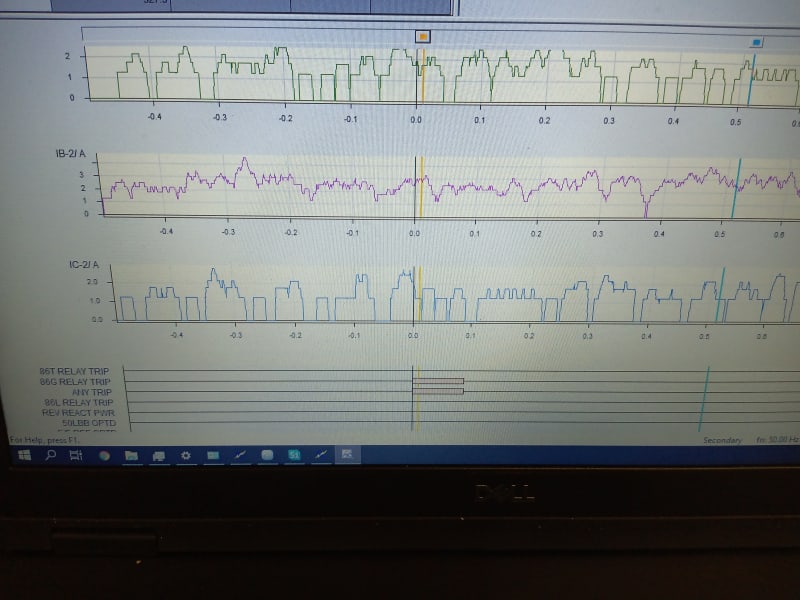

When I right click on REG630 Final, I can view Event Viwer & Disturbance Handling. I do not see anything in the Disturbance handling. I cannot open an event to view the curves of voltage and current and the digital signals as Generator breaker , Turbine Trip, etc.

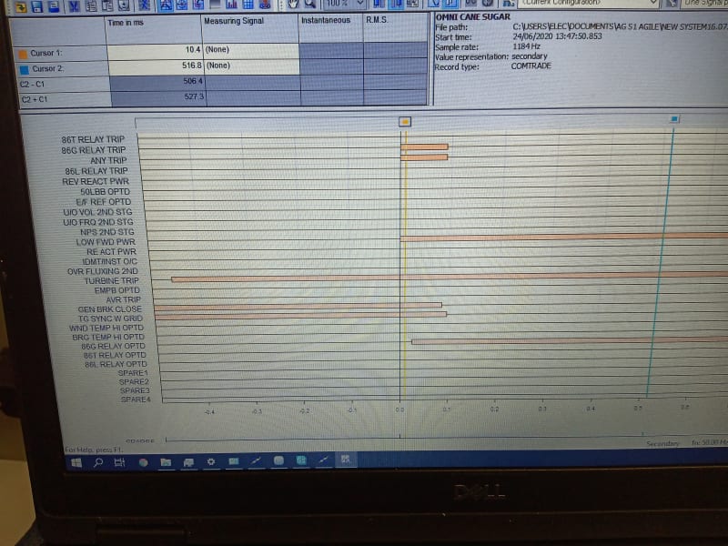

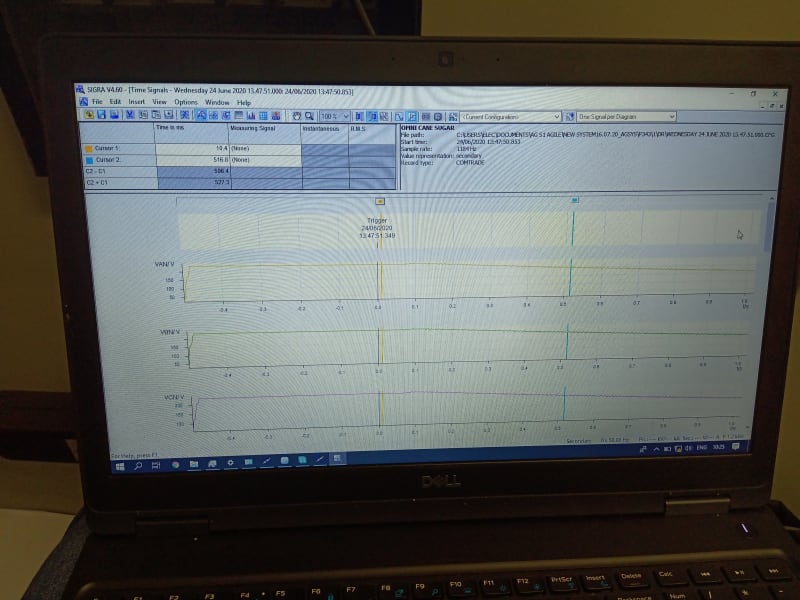

On another relay Micom P40, I can view the event, download them as comtrade and view in a software as below.
Can you plz give me the steps to do the same in the ABB REG630? Thks
Right click on the background of the Disturbance Handling tab and select "Read Recording Information" Then right click the one you want and click "Export Recordings" to export he comtrade file which can be opened in Wavewin.
Here is a video I just found on Youtube, it is not in english.
Also, at the top where it says Local Recordings, you might have to change that to All Recordings.

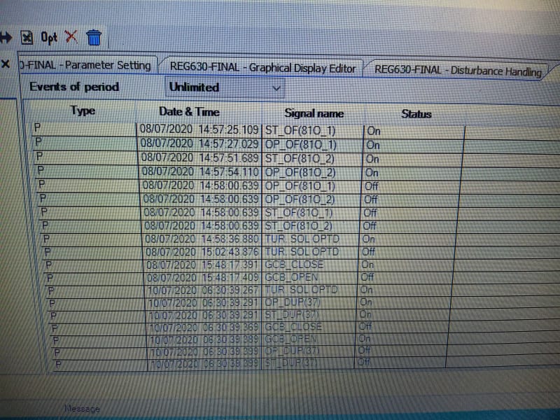

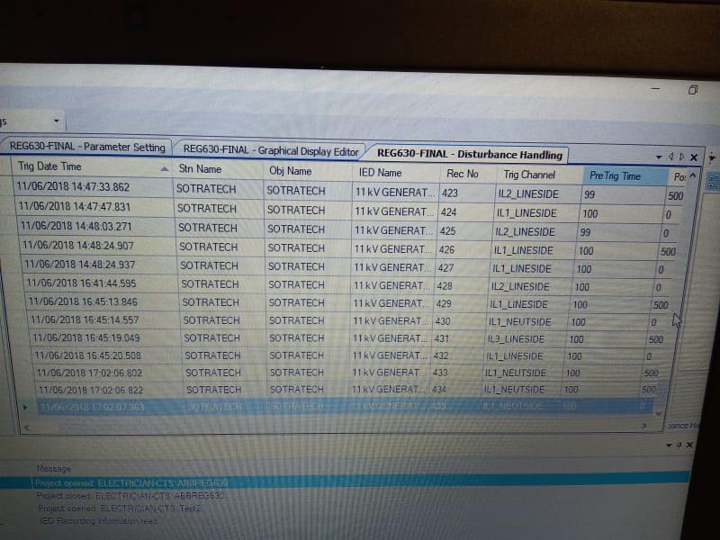

I can view the events and disturbance handling in the relay REG630. However I cannot open an event to view in a disturbance analyser. Also in the Event Viewer I can see events up to July 2020 whereas in the Disturbance Recorder, I can see recordings for June 2018 only. I do not see disturbance recordings for July 2020 although we have started and stop the plant.
I see lots of recordings in the disturbance recorder for IL Line and Neutral. We would like the disturbance recorder to record events when the turbine or alternator trip or other important events.
Can you plz advise me how to do so?
Everything can be done, but its little complicated. You can start by checking application configuration / parameter settings for function block RADR and RBDR... and refering to technical reference manual for REG630.
