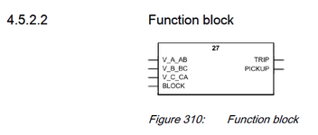

Hello,
ABB REF615 Under-voltage Block Phase voltages input not active when inserted in relay configuration page.
BLOCK input is the only input available.
How can I make V_A_AB, V_B_BC, and V_C_CA input available in function block 27? I need use voltage measurement inputs for under-voltage trip.
Refer Application Guide for REF615. This guide has Standard configurations section wherein, various possible connections are shown.
You should find a clear answer to your query.
The document is freely downloadable from ABB website.
In ABB 615 and 620 series protection relays voltages and currents are internaly routed to protection function blocks. You can see those internal routings in application manual.
