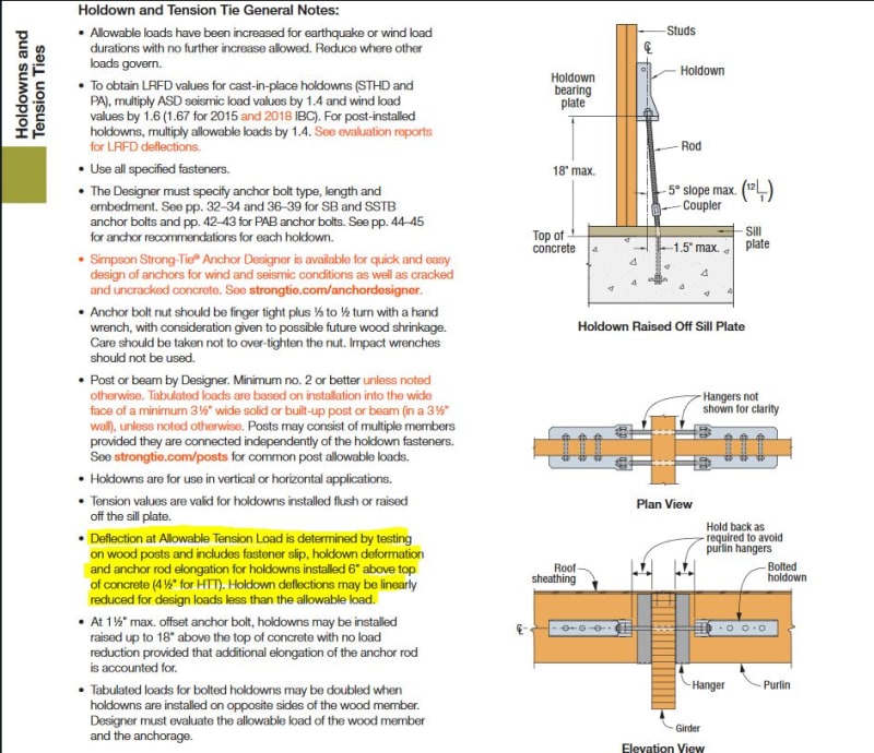

Is it not a footnote in the Simpson catalogue that you can linearly reduce the holddown elongation/slip based on the actual serviceability load demand? I often find myself messing with the hold downs to get some wall segments' deflection within limits, so reducing that elongation where possible seems worthwhile to me (especially in wind-governed design).
Craig, it sure is good catch.
Thanks for that screen grab! Now that I have my own catalog in front of me, the limit states catalogue says the exact same thing (just with "Allowable Tension Load" replaced with "Factored Resistance"). Since deflection in limit states design is dictated by serviceability (unfactored) load combinations, the hold down deflection/slip can often be significantly reduced from the catalogue value. For wind governed design, you get a reduction approximately equal to your wind load factor, even if you are at the full strength demand under ULS load combinations.

Craig and RWW0002 - thanks for that! I must have skimmed over it somehow. I found the concrete offset explanation in the third party reports, but they didn't get into linear reductions.
