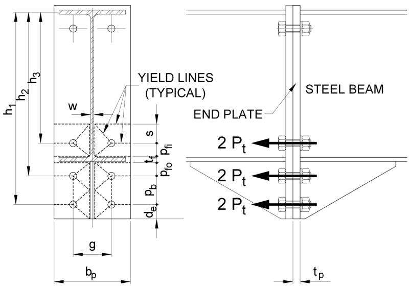

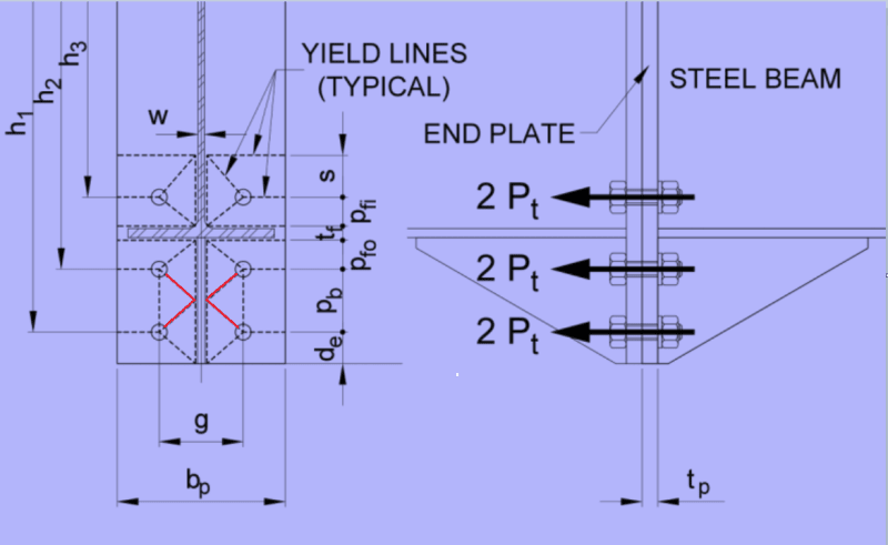

I need to provide a moment connection to splice a beam. Space is limited and the entire length of beam cannot be installed in this existing building, so needs to go in 2 parts. Moment is always +ve and only need bolts on one side of the beam.
Does anyone see any contraindications for the connection (in sketch)
I propose to design?

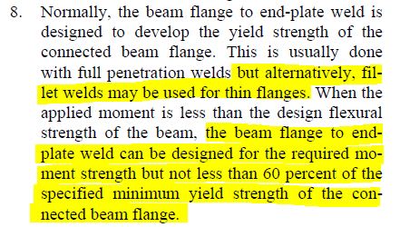

4 bolts at the one side doesn't do it unless I go to 1" dia and not 3/4" dia (client's preference). I also note the AISC uses a CJP or PJP weld at the flange to the end plate. Any reason this cannot be a fillet weld?
Dik

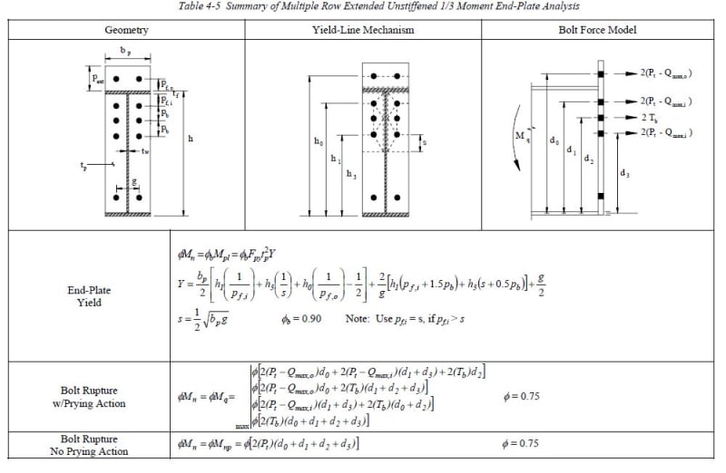

Hi dik,
You can refer to AISC Design Guide 13 to design the splice. Your design model seems valid to me, but there are some options that you can take from the design guide.
There is nothing in the AISC that prohibits the use of fillet welds for end plate connections (unless it is a high seismic design, which doesn't seem to be the case here). There are many design examples throughout the AISC design guides and manuals in which they use fillet welds for the beam flange to end plate joint.
Found it in DG 16... thanks

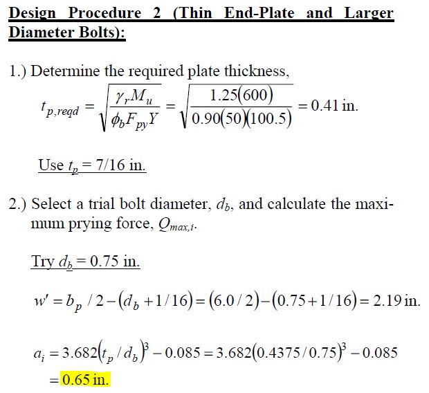

Any idea of units? Just drop the inches?
Dik

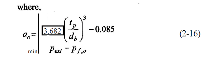

Where you get that equation from?
Yes, the results are given in inches, see the design example below.
Here are some interesting notes on the design of the weld between the beam flange and the end plate.

It's from DG 16...
Dik
Thanks... the formula gives a minimum value to use one unitless and one in inches. SMath pukes when units don't match. When I finish the program I'll post it here for comments/others to use.
Dik
Dik,
Yes, aois in inches. See DG16 p.61 "App. A Nomenclature" for explanation.
Dik,
I could have missed something on DG16's equations, to me, they are not always unit consistent. So program your worksheet to restrict the unit of input field, but carry out unitless calculation in the operation to avoid your program from puking :)
Easy work around... you divide the variable by the unit to make it unitless. It always raises the question if the formula is correct.

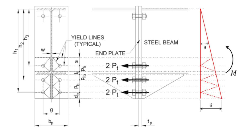

I am not convinced that the yield lines shown in red actually occur. If they are removed, there is a trapezoid each side of the vertical plate which has a single slope.
BA
Due to the virtual rotation in the connection, the virtual displacements at each bolt lines are different. Therefore, those yield lines are required for compatibility and to complete the plastic mechanism. In other words, without those red yield lines there would be no kinematic mechanism.
Bart... they happen for compatibility...
Dik
Yes, I see it now. Thanks PROYECTOR. Excellent explanation. I should have seen that for myself.
BA
Yes, thanks Proyector. When BARetired posted his comment, I was walking along the path with him. I was 75% of the way to convincing myself that he was right before I read your post.
Note: This is why I like Eng-Tips. When someone challenges conventional thinking (even when they're incorrect) it forces us to better understand the issue and why "conventional thinking" is right or wrong.
