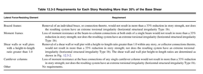

There are two values of the redundancy factor: 1.0 and 1.3 . Pls look to Table 12.3-3 ( Requirements for Each Story Resisting More than 35% of the Base Shear) for t he calculation requirements..If the failure of a single element of the seismic force-resisting system will result 33% reduction in story strength, or does the resulting system have an extreme torsional irregularity, penalty factor of 1.3 is used.
There are two tests ; aspect and calculation ..If you post the structural plan, you will get comments for aspect , regarding calculation, you shall carry out the calculations mentioned Table 12.3-3 .

For ρ to be 1, code says "Each story resisting more than 35% of the base shear in the direction of interest shall comply with Table 12.3-3." and for Moment resisting frames it is stated in Table 12.3-3 ,"Loss of moment resistance at the beam-to-column connections at both ends of a single beam would not result in more than a 33% reduction in story strength; nor does the resulting system have an extreme torsional irregularity". How do I check "Loss of moment resistance at the beam-to-column connections at both ends of a single beam would not result in more than a 33% reduction in story strength"?
Mr. ANWAR, I do not look to threads everyday... Regarding ' Loss of moment resistance at the beam-to-column connections at both ends of a single beam would not result in more than a 33% reduction in story strength'..the configuration of the columns implies , the widths of the frame elements restricted with wall thk.
One can say without calculation, removing one of the beams will not cause to a reduction by more than 33% of the lateral strength of the structure. However, can not say without calculation , the removing of a beam will not cause excessive torsional irregularity.

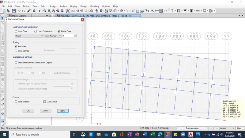

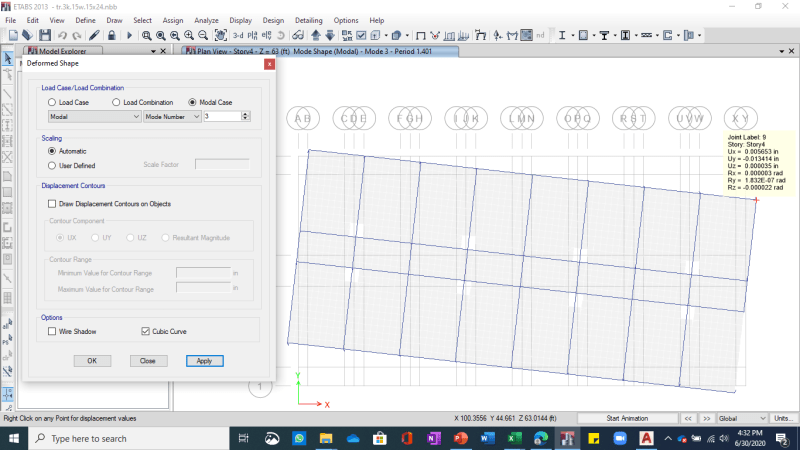

My building is 4 story (G+3) + a pitched roof above. But only 4 stories resist more than 35% of base shear. So I exempted roof from the check.
I did the following process.
1) Removed the beam from Y/2-3 in 4th story. (Do I need to check for other stories?).
I noticed story shear reduction of less than 1 kips (original was 177 kips)
2) Then I checked for mode 3 as follows
 https://files.engineering.com/getfile.aspx?folder=fe1de2a1-1877-4e85-905a-7550315e80cb&file=Screenshot_(68).png
