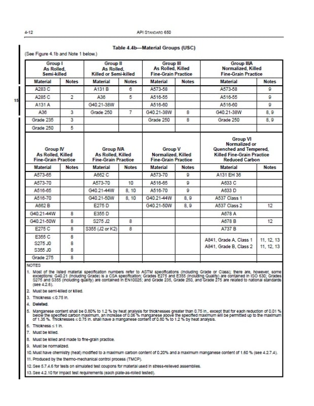

Thanks for your rply, actually tank has designed by a third party consultant and we are a subcontractor for the fabrication and erection including material procurement. Actually our client is concerned about API650 standards for all material, we have agreed for shell plates and roof&bottom structurals. But as per client that is not enough and they wanted for all materials like the platforms, stairway, walkway. So when I have gone through the API 650 standard, plates and structural (coming under materials section.4 and 4.4 structural shapes) shall be controlled with Manganese in between 0.8% to 1.2% and the client is stick on that section and compelling to fabricate platforms, stairway, walkway with Mn controlled(0.8% to 1.2%)material as per API650. What my understnding that it could not considered as direct material and not be considered under API 650.
so my concern is whether Mn control is compulsory for all materials which all using for platforms, stairway, walkway?. I need to break their arguments with evidence, otherwise, they will not accept :(

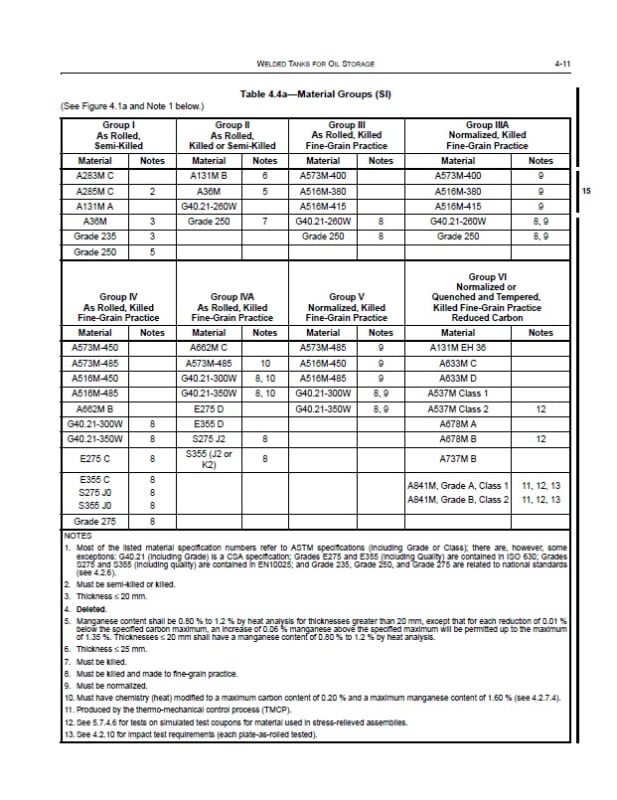

Aren’t you talking about table 4.4a? For material A36?
I think this table is only grouping the material for shell, roof, and bottom plates and reinforcements etc.. not structural elements...

The only reference I can find to Mn limited to 08% to 1.2% is in Table 4.4 Note 5. However all the places this Table is referenced are in Section 4.2, which is plates not structural. I wonder if they are assuming that the Table numbering matches the Section numbering it applies to? It doesn't match.
(As a complete aside, since this Table isn't applicable, why do they insist on looking at the Group II A36, which calls for Note 5, rather than the Group I A36 which only requires Note 3?)
As you've noted, structurals are covered in Section 4.4, and there are no restrictions on the A36 chemistry in 4.4.1.a. As a second proof that the Mn limit isn't applicable, you can use plain A36 in AISC, and all materials listed in AISC are permitted under 4.4.1.d.
After 35 years designing tanks I'm still surprised that I can run into new ways for customers to misinterpret the Code. But it keeps life interesting I guess.

There are two tables 4.4a and 4.4b material group coming after section 4.4 structural shapes, what is that means or representing
Table 4.4 has nothing to do with structural. You must read the Code to find references to Table 4.4.
For instance:

The key thing to note is that all these clauses are in Section 4.2 which is plates, and the reference to Figure 4.1 is also in Clause 4.2.
Table 4.4 does not apply to structural, even though is uses the same numbering.
