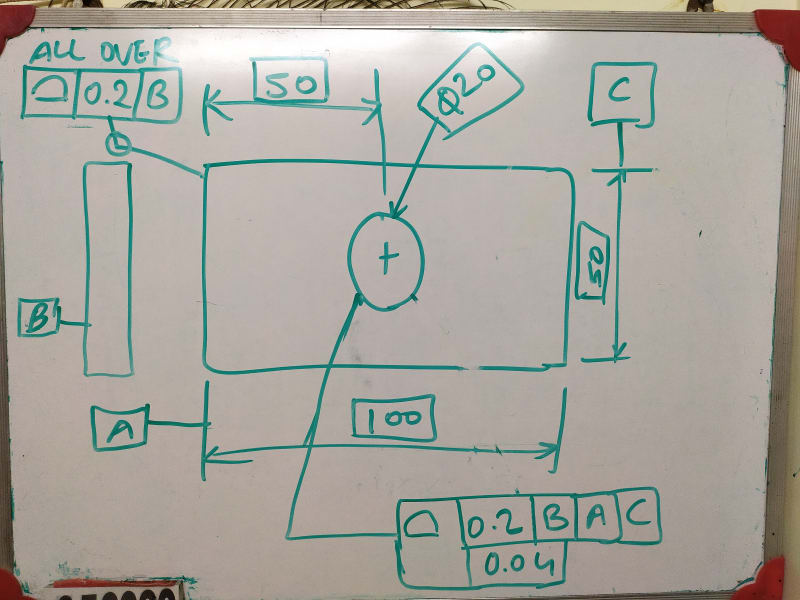

Profile tolerance with datum B, will control the 100 between 99.8 and 100.2 be parralel plane
50 between 49.8 and 50.2 by parallel plane
Clearly understood.
Dia 20 profile tolerance with B A C will control the circle between 19.9 and 20.1 by concentric circle.
0.04 will control the form.
Clearly understood.
How the location of circle (50) is controlled by profile tolerance. Whether by dia 0.2 or parallel plane 0.2.

I guess in order to provide some meaningful answer here, you need to clarify what you are asking. I have no idea what is/ are your question(s).
The drawing is poorly made.
Is profile 0.2|B| applicable to the bottom feature or to the right feature?
and after that you just put some words together but no much significance in the English language.

Agreed there are some issues with the drawing. You have questions about an all around profile symbol (as well as a general note, which is not shown on your sketch or provided in the body of your post to know what you're talking about) - if you wish the 0.2 profile to |B| to apply to all the surfaces which make up A and C then yes it needs the all around symbol attached to the leader line.
If you wish the composite profile to apply to the central 20mm feature, then it needs to be applied directly to it with a leader line NOT the dimension (right now its actually floating oddly next to the basic dimension - its not even clear what it applies to).

ALL OVER symbol missed in profile 0.2 datum B.
As per standard, profile controls location.
Here the location 50.
If I applied position tolerance, the dia 0.1 tolerance zone wrt datum BAC.
What is the geometric tolerance shape of dia 20 location (50).
What will be the minimum and max location of the 50.
Is it 49.9 and 50.1?

Here is corrected drawing.
What is the meaning of FCF?
Profile controls the surface of the feature, not the axis. There is some indirect limitation of how far the axis may deviate, but it is not a simple relationship like 50-(0.2/2) it would have to be modeled in CAD.

Sa-Ro,
Your sketch on (15 Jun 20 14:50) is conflicting - you have the notation "ALL OVER" combined with an All Around symbol on the leader line. See the differences between the definitions and the symbols - you need to choose one. You can also use the symbol on the leader line OR the actual words (ALL OVER or ALL AROUND) attached to the FCF, but you should not use both it would be redundant.

For 1,2, and 3 see my response above (15 Jun 20 15:00). 4 is not a valid specification in my mind, as the All-Around notation requires it be applied to a specific true profile in a specific view - if applied as a general note it is not clear what true profile it applies to.
It is ALL AROUND - Single circle only.

So for cylindrical feature, position tolerance is better to locate thru dia 0.1 than profile tolerance.
Presumably you are talking about the 0.2 profile tolerance to |B| on your (15 Jun 20 14:50) figure (context matters). If so you need to EITHER have "ALL AROUND" applied to the FCF OR have the All Around symbol (single circle) applied to the leader line. You should not have both.
Does the rest make sense?
It is not necessarily better, just different - it depends on what best communicates your design intent and best represents part function. At RFS position you control the axis. At RFS profile you control the surface.
