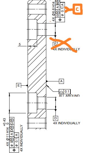

Sa-Ro said:
Datum B is axes with two perpendicular plane which can rotate about datum B axes and perpendicular to datum A. then how clocking not required. In study materials also, explaining as "to orient a feature, clocking datum must be declared".
It is the pattern C that would define the orientation. So the profile tolerance for the outer contour would have to reference A|B(M)|C(M) in order to have the outer contour oriented to the pattern.
Sa-Ro said:
If dia 6.6 holes is datum C (without 4X INDIVIDUALLY) How to address each counter bore with corresponding dia 6.6 hole?
Look again at my last crude illustration. I deleted D at the top hole and moved it to the hole at the bottom and this is where the entire definition on the Individually basis would be defined. The position tolerance for the counterbores would not require C, as mentioned earlier by Evan(axym) and it would have to be changed from composite to position + perpendicularity.
Sa-Ro said:
7.a) Dia 6.6 holes are nothing to do with 6.3 slot and datum A. Because datum E is placed on assembly bed, dia 6.3 hole and 6.3 slot is used to locate and orient the assembly. Dia 28 axes should be aligned with end function.
But there needs to be something that will orient the dia. 6.3 hole F and the 6.3 slot G with other features of the part. You want to use hole B for that. I say you should consider pattern of the dia. 6.6 holes.
Sa-Ro said:
7.b) Horizontal position wrt datum |E|F(M)| - OK. But orientation with datum B?
MMB of datume B is 0 to dia 0.21 (28.21 - 28)
This is not how MMB of B should be calculated. MMB of B represents a boundary that will not be violated by the surface of the hole B when the hole is considered with respect to the higher order datums, in this case |E|F(M)|. This will not be easy calculation, I can tell you.

Here the updated drawing. PFA.
Design requirement:
1) Product will be placed on Datum A.
2) Dia 28 bore is used to locate the product.
3) Dia 6.6 holes is used to align and mount the product.
4) Outer edge of the component shall not project outside the product (56.5 X 72.5)
5) Datum E placed on customer machine.
6) Dia 6.35 hole used to locate the assembly.
7) Dia 6.35 slot used to align the assembly.
8) Dia 5.5 holes used to mount the assembly.
In addition to above, dia 28 and dia 6.3 holes are to be aligned. Axes from dia 28 will be connected to end application.
 https://files.engineering.com/getfile.aspx?folder=ab029227-ec9f-4c27-b40f-57228d52c4d9&file=Flange.PDF
Kedu,
Yes, this has been my pet peeve too. I just did not want to add it to this particular discussion as I think there are more fundamentals problems to solve before we can even get to this type of advanced and philosophical topics (especially that even Y14.5 does not seem to have a problem with it).
Couple of observations regarding the latest drawing attached:
i.) duplicate datum feature C: remove C from 56 width basic dimension
ii.) Ø6.3 top hole is not related to the main coordinate system A|B(M)|C(M)|. Should as use a position to A|B(M)|C(M)| and a perpendicularity to D and this hole, as shown become E. Obviously, remove current shown position to D|C(M)| which does not make any logical sense.
iii.) slot width should be dimensioned as explained by pmarc, 6.3 width positioned to D|E(M)| and become F.
currently shown position to D|E(M)|C(M)| is illogical and, as stated by pmarc the MMB boundary cannot be calculated (at least not easy)
iv.) bottom slot height/length location should be shown from its height's of length's extremities and not attached to 2mm dimension. Should be from A|B(M)|C(M)| or from D|E(M)|F(M)|. I prefer the latest, but if pmarc has his strong arguments I can accept the former too.
v.) If you got rid of the INDIVIDUALLY callouts for the C'bore and for its applicable datum feature its okay, but I hope you realize now the design is more stringent. If functionally this stringency is needed or not you have to decide.
vi.) Composite profile for D can be replaced with a profile single segment within 0.2 and flatness within 0.1. In my opinion this is more straight forward than the composite.
vii.) Why on Ø5.5 H14 holes you have H14 and also +0.3/0. Is it needed? If yes, shouldn't be within parenthesis ()?
Sa-Ro,
I notice you have covered this new drawing with "MAX" notation. What is your reasoning behind limiting the MMC position tolerance to a certain maximum value in every case? I can see some reasons why one might want to utilize this, however it seems to me it would be the exception not the rule as in most cases it is an undue restriction on the available MMC tolerance and prevents the effective use of hard gauging. Especially not for something as simple as a bolt clearance hole and counterbore. You even have it applied to at least two RFS position tolerances which by definition cannot exceed the tolerance specified in the FCF (or perhaps you mistakenly specified RFS instead of MMC).
Also the position tolerance applied in the vertical direction for the slot is incorrectly applied, it must be applied to the physical feature not the center to center distance of the radiused ends. See Y14.5-2009 fig 7-34 for proper MMC position applied to a slot.
Dia 5.5 H14 0.3 provided for discussion only. Usually we provide Dia 5.5H14 only.
No functional requirement for MAX. It can be removed.
