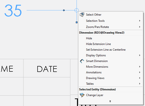

Jun 9, 2020 #2 Sa-Ro Mechanical Joined Jul 15, 2019 Messages 279 Location IN First dimension as usual. Then right click on arrow head and you will get types of options. Refer: https://forum.solidworks.com/thread/227732 Upvote 0 Downvote

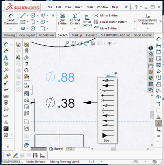

Jun 9, 2020 Thread starter #3 Tarator Automotive Joined Sep 20, 2013 Messages 176 Location CA Sa-Ro, When I click or right-click on the arrowhead, I get this, which changes both arrowheads to what you choose, which I do not want Upvote 0 Downvote

Jun 9, 2020 #4 Sa-Ro Mechanical Joined Jul 15, 2019 Messages 279 Location IN Click on that small circle and again do it for arrow. Sometimes it may applied to both. We have to correct anyone. Upvote 0 Downvote

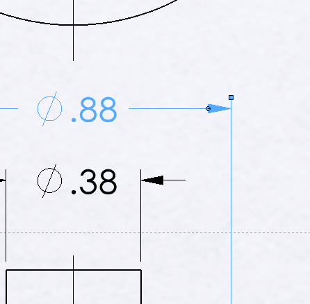

Jun 9, 2020 #6 Jboggs Mechanical Joined Apr 27, 2012 Messages 1,065 Location US After you click on the dimension it looks like this: If you left click on the little circle on the arrow, the arrow will switch to the outside of the extension line, and vice-versa. If you right click on the little circle on the arrow, you get this on-screen menu: That menu only changes the single arrowhead selected. Upvote 0 Downvote

Jun 9, 2020 1 #7 Sa-Ro Mechanical Joined Jul 15, 2019 Messages 279 Location IN Click that circle. Upvote 0 Downvote
