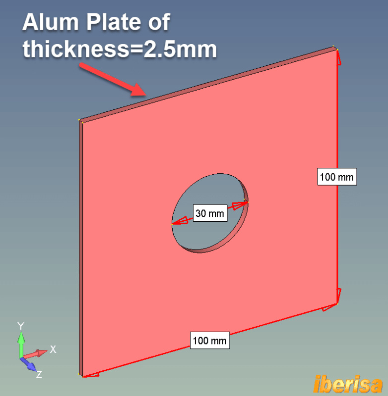

Hello everyone,
I have started a new project in patran consisting in studying the behaviour of a plate drilled in the middle, but this work is led on a quater of the plate in order to reduce the time of calculation and so on.
The plate is constraint in one direction on its left side and loaded on its right side by 10KN. I have several questions in my mind:
are there any symmetric boundary condition to define (like checking an option idk) for studying the quater of the plate and getting the same results as a full plate ?
and if it is not the case, what constraint I should apply on the left side of the plate and on the inferior border ?
What i have thought to understand is that i need to lock the curves belongings to symmetric plane in a perpendicular direction of the latter, but i m not sure.
[highlight #EF2929]You may find a drawing of the situation attached[/highlight]
thanks a lot for your replies,

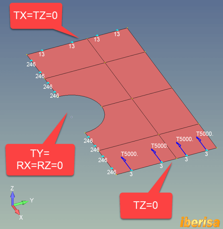

Plane with normal Y:
Y=0 RX=0 RZ=0
Plane with normal X:
X=0 RY=0 RZ=0
apply half the load
you shall also constrain a grid point in Z to solve.

2.- But if you have a general plate situation where buckling could exist due to its low thickness, then the above assumption is not correct at all, I will explain with your example: let's imagine your plate is an aluminum 6061-T6 thin plate with thickness = 2.5 mm only and loaded at both ends with opposed loads of say 10 KN.
The correct assumption is to create the MIDSURFACE of the solid geometry and mesh your problem with 2-D Shell CQUAD4 4-nodes elements with 6 DOF per node, this way you can perform an Euler linear buckling analysis (SOL105) or if you like a full nonlinear analysis activating both geometric & material nonlinearities with any of the nonlinear modules you have (SOL106 or modern SOL401/402), and probably you will receive a big surprise in the limitations you will have in the maximum load capacity of the plate, OK?.
Lets see what happens: The total applied load is FX = -10e3/2 N = -5000N because we study half model by symmetry regarding the Z-X plane, then the constraint to apply to edges in the middle of the plate are TY=RX=RZ=0: we need to constraint not only displacements of translation normal to symmetry plane (TY=0) but also rotations out of symmetry plane, then RX=RZ=0.
In the edges to the left of the plate we apply TX=0 but also TZ=0, we need to constrain the plate in Z-axis direction to avoid rigid body motions.
Also in the edges to the right of the plate we set TZ=0, reasonable assumption, the edge follows the load direction.

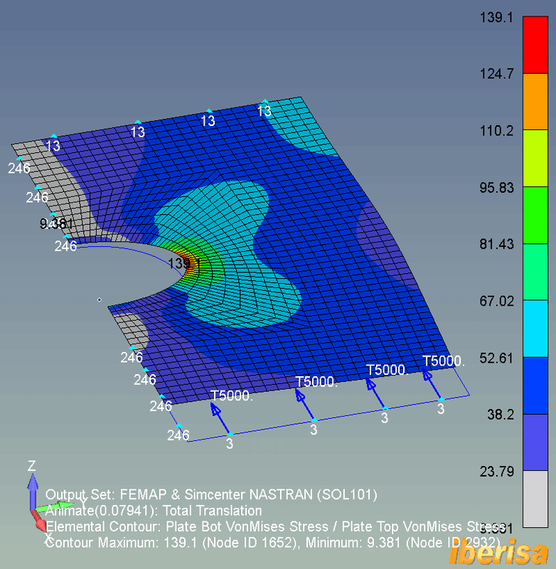

• The following animation shows the stress results of the linear static analysis (SOL101) of the plate: because not any load exist out-of-plane in the Z direction, then the deformed shape is constrained to the X-Y plane of the plane.
• The maximum resulting vonMises nodal stress is around 140 MPa, if the 6061-T6 Yield Stress = 241 MPa, we have a factor of safety around 241/140 = 1.7, not too bad.

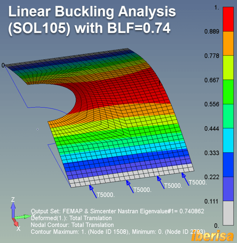

LINEAR EULER BUCKLING ANALYSIS (SOL105)
But what will happens if I run a linear buckling analysis to check the limit load to see if any instability could exist: surprise!!. The Buckling Load Factor BLF = 0.74, then because BLF<1 this means that the limit load = 0.74 x 10e3 = 7400 N only!!. The plate failed at the original load of 10KN by buckling.
In summary, you see how is life, from the point of view of a simply linear static analysis considering the material properties the solver tells you that no problem exist because the applied load do not exceed the yield stress of the material. BUT Linear Buckling assesses stability under loads; it examines structures for sudden failure modes caused by compressive forces. In chunky thicken solid modes buckling never is a problem, but in thin plates you see that lack of stability is many times the reason a failures in the real life, OK?. Lesson learned: run always both linear static & linear buckling analysis to check that both material & stability pass.
