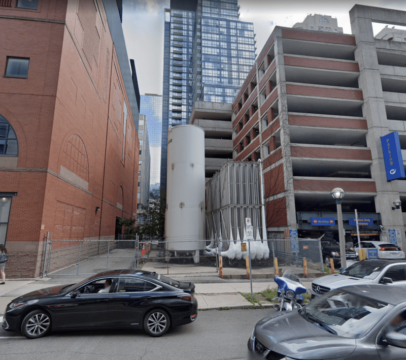

Anyone have any details about the explosion of the LOx tank at a hospital in downtown Toronto? It looks like the vacuum jacket top head was ripped off but what would cause that to happen in such a catastrophic way?

The event was most likely started by a leak between the liner and the outer shell. This space is normally filled with loose perlite and then pumped to good vacuum to create the Cryogenic rated insulation.
If this vacuum space gets a small amount of LOX in it the space will overpressure, and blow out the rupture disc. The rupture disc is set to protect the liner from crushing (external pressure). At the time of the video there is still a considerable amount of LOX in the tank, the liner may be torn but if not the boiling lox will be venting out relief valves, so further trouble is unlikely.
It is an expensive failure, as the tank is likely not repairable.

Here is what the tank looked like (Google Street-View, screen-capture):
Lots of frozen condensation on the radiator to the right.
The frozen condensation is a given; seems light given other evaporators I've seen.

LOX does scare me, but this almost a non-event. It is likely that they are using less oxygen these days with less elective surgery going on these days. When the over pressure relief blows it is supposed to vent up a stack, but it looks like the line leaked into the vacuum and blew out some of the vermiculite. MVE (or whoever built the tank) will be able to fix this easily.
