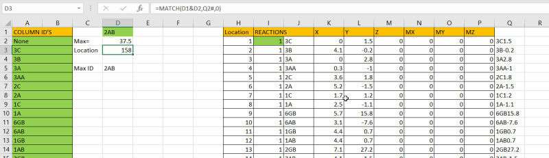

Thank you for any help before hand. I am stumped on what to do here.
I am trying to lookup the maximum value with a if criteria in the maximum formula. I then want to know the location of the maximum value. The problem I am having is that when two values has the same maximum value, my formula will return the location of the first time the maximum value occurs. I have attached a pdf to better explain my issue. I will also be uploading my excel shortly.

Why would you not use INDEX()?
In your example, the two rows are adjacent.
Can you get multiple rows for some value that are not adjacent?
Okay, I had some time to snoop.
3C returns Max Y 1.8, Location 5. But here's what's in the table...

I'd set up an extra column combining the text and the value, then you can find the maximum value and use match on the extra column with =(D1&D2) to return the row offset for the value you want.

D'oh - I should read the whole thread before working on a solution. I just did what I suggested back in June.
Here are the results anyway:
Spreadsheet attached.
Column Q combines the ID code and the value, so you can do an exact Match on that to find the row number with the maximum value for the selected ID.
The formula in column Q is =J2:J10244&L2:L10244, entered as an array formula (select the range Q2:Q10244 then press Ctrl-Shift-Enter), for compatibility with older Excel versions. Alternatives are:
- Enter =J2&L2 in cell Q2 and copy down as far as required (also works in older versions)
- Type =J2:J10244&L2:L10244 in cell Q2 and press enter. In latest Excel versions this will generate a dynamic array, filling the cells down to row 10244 automatically.

@Doug, I usually try to avoid using helper columns. But that often raises other issues for me like enabling macros et al., especially when there might be corporate restrictions. So I really like the simplicity of your solution. I'll be more open to considering that option in the future.
