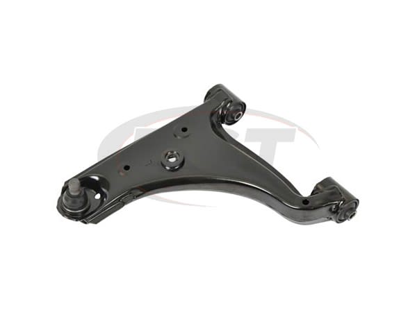

I sandblasted 2 front control arms, pressed out the factory bushings, welded reinforcements for the link kit cups and welded steel loops for suspension travel limiting tie down straps for drag track use. Then installed 4 Nolathane polyurethane bushings.
The factory front control arm bushings are chemically bonded to the center sleeve, when the control arm is bolted to the crossmember at the ride height position (about 15degrees downward) the factory control arm bushings have a torsion resistance, it takes about 200 lbs pressure on old bushings to raise the control arm level with the crossmember so the factory front control arm bushings have a combined maximum resistance of 400-500 pounds. So if you remove the struts with springs the front control arm bushings will hold the front end of the car up and keep the crossmembers from hitting the ground.
The new Nolathane bushings use a greased center sleeve, the poly bushing is a bit longer than the center sleeve which would add some pressure to the center sleeve. But because it is greased at the center point the control arm will at some point move up or down on the center sleeve.
My concerns is that at the point the bushings move on the center sleeves, to the struts, springs and sway bar it would be as though the front end weight of the car has increased or the spring rate and swaybar size was lowered.
These are the bushings:

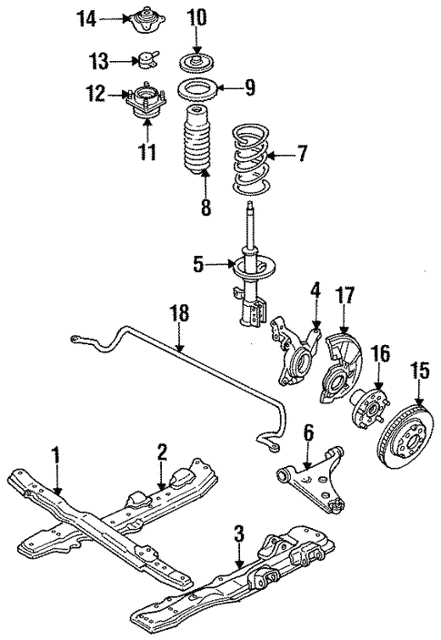

This is the crossmember set-up:
A bad drawing.
I have read about wear/cupping and abrasion of poly bushings with free floating components.
But in this case both ends of every poly control arm busing is boxed in by the cross member, it's a bad drawing but they are completely covered, because the bushing center sleeve is exactly the length of the crossmember opening and the bushing is longer it will be crushed into the crossmember box making it very hard for any dirt to get in between the crossmember metal and poly bushing ends and even harder to get between the center sleeve and bushing.

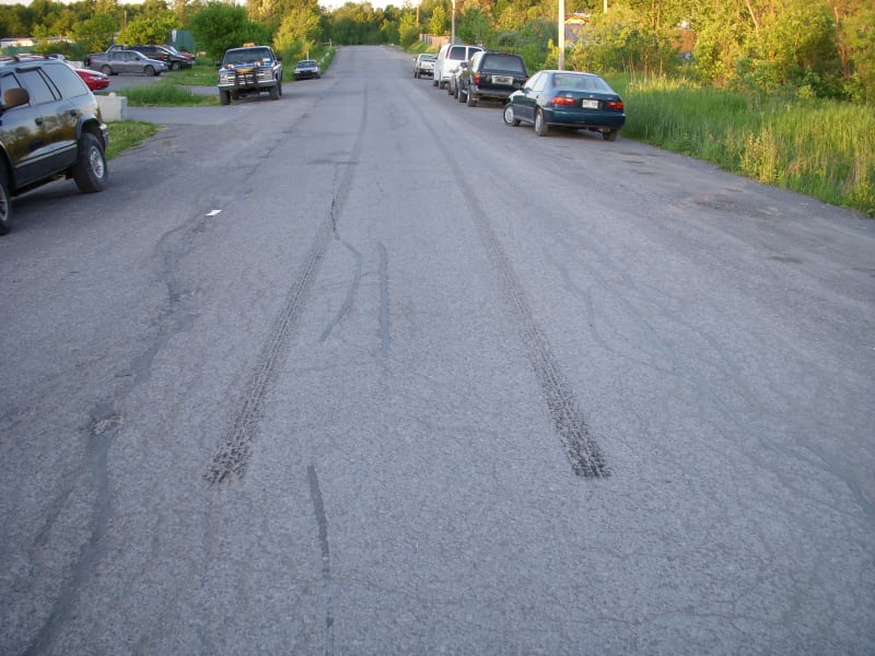

My garages old location was next to a never used industrial road, the road was brutal. My friends and I and the other shop owners and their friends all raced on this road, I can't count the number of cars that bottomed out and cracked their oil pans, I never worried because the cross members sit lower than the oil pan and go all the way to the front making it impossible for the pan to hit the grown on a flat surface but the crossmembers never bottomed out, the cars handled all the dips and potholes under heavy acceleration in a straight line.

What you're doing there is bad on two accounts. First, you're exaggerating the amount of over-constraint, which the chassis brackets don't particularly like when there's any off-axis rotation, or when pairs of chassis-side sleeve axes are parallel but not concentric.
And second, you're basically "wasting" some of the fastener installation torque ending up with less clamping load through the sleeve, making it more likely to slip around in the bolt to hole clearances as the suspension moves under load.
For the suspension to actually function, that's what you want. Polyurethane is far too rigid to allow much suspension movement via compliance. Yes, the effective wheel rate would be reduced, but that may not be a bad thing (think reduced variance in wheel loading over any given amount of suspension movement, which can't be completely eliminated).

I didn't design the Nolathane bushings, that's the way they they came and are meant to be installed.
Again this isn't rock hard Polyurethane.
I doubt the sleeve will slip when bolted to the cross member.

This video was after I installed the axle nuts in the crossmembers, the car is running 21psi boost on a T3 45trim turbo(Now 26 psi on T3stage3 T4 76trim):
Link
This is on Vernan Road and was filmed in 2005, after the last few winters of constant freezing and thawing all the roads here are as bad or worse than this road was. Vernan road today is way worse than it was then.
Both front wheels pull evenly, this car has manual rack and pinion and I blame the right dip in the burnout on my driving with one hand on the wheel for the first few seconds, not torque steer.
