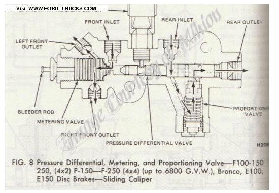

The initial proportion of front-rear braking force is determined by the relative diameters and numbers of hydraulic cylinders, both in the dual master cylinder and in the wheel cylinders.
Brakes-Shop.com said:
Combining Strategies – The Misnamed Proportioning Valve
Conventional proportioning valves should really be referred to as “braking force regulators” or “brake pressure regulating valves.” While their name might imply true proportional control, in reality they provide a combination of the control found in Figures A and B.
Up to certain pressures, these valves allow equal pressure to both the front and rear brakes (à la Figure A). However, once a preset pressure point is reached (600 psi in the example), the rear brake pressure continues to build, but at a slower rate (or slope) than the front brake pressure. Figure C displays this for us quite clearly.
You will find a true proportioning valve on semi trailer tractors.
It is called "Bob-Tail Valve" rather than a proportioning valve.
When a semi tractor is running without a trailer the back end is very light and prone to locking up.
Hence the Bob-Tail valve.
This is a true proportioning valve and directs a much higher proportion of the braking force to the front wheels when a trailer is not connected.

Bill - a dual master cylinder wouldn't have been used in 1960. The 4 wheels all get the same brake pressure.
Was here any requirement for the front and rear wheel cylinders to be the same diameter or for the front and rear brake drums to be the same diameter or width?
The master cylinder wasn't the only cylinder.
Ohm's law
Not just a good idea;
It's the LAW!
It says in the article that the wheel cylinders were different diameters. GM knew a thing or two about brake balance, even back then.
I don't think proportioning valves were in use in that era, so it would have had fixed front-rear brake balance, picked at a certain representative deceleration (looks like 0.5 g).
Many so called proportional valves are not proportional valves.
There is a valve that is common on domestic cars that. as I understand it, does not allow pressure to the back wheels until a small pressure has been applied to the front wheels.
There are few true proportional brake valves in use. Most of the valves that are called proportional valves to not perform a proportioning function.
Some so called proportioning valves retard the onset of rear braking slightly, but not proportionally.
Some so called proportioning valves retard the maximum pressure of rear braking slightly, but possibly not proportionally.
There may be a need for a true proportioning valve on a truck that is either heavily loaded or unloaded and very light on the back.
Unfortunately this need is seldom addressed.
There are available adjustable, true proportioning valves but though I have seen a catalogue listing I have never seen one in the wild.

Nowadays, ABS mostly renders all this obsolete. There will be a front-rear balance applied just like in the old days (determined by relative piston sizes front and rear, with the same hydraulic pressure applied throughout) but if ABS or ESP or EDL (electronic differential lock!) determine that something should be done differently, the ABS hardware is used to either reduce applied hydraulic pressure or apply extra hydraulic pressure to individual wheels.
Then there's regenerative braking ... My Chevy Bolt has a normal master cylinder and ABS module but it has an electric servo actuator in place of the usual vacuum (or hydraulic) power-brake servo. If you apply brake pedal lightly in normal driving, it uses regenerative braking via the drive motor to do the braking and it uses that electric actuator to simulate the normal brake pedal feel, and the hydraulic brakes are not applied until you actually come to a stop. If you stomp on the brake pedal (panic stop), your applied force on the pedal powers through whatever that actuator does, and the hydraulic brakes take over. If ABS activates, it de-activates regenerative braking and goes into normal hydraulic braking with ABS activation. If there's a big failure of on-board electrical control systems, you stomping on the brake pedal will power through the actuator and apply hydraulic brakes as normal. This all works quite well, and the brakes feel like those in a normal car.
The de-activation of regenerative braking and use of the normal friction braking when ABS activates, is probably because with the car being front wheel drive, regenerative braking can't be applied to the rear wheels. Doesn't make a whole lot of sense to have front braking limited by ABS while the rear brakes aren't contributing anything.
These things tend to have a 2 stage proportioning effect, backing off the rear brake at high decels to account for weight transfer
