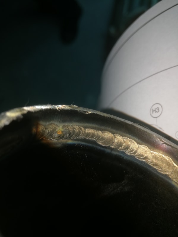

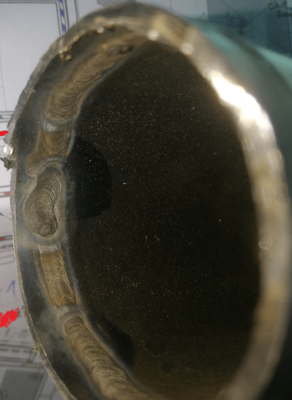

It's a bit dumb to ask the questions, since there's no conclusions to be drawn, but maybe you guys can look at this weld and tell me what it looks like to you. The pipe was installed on what is supposedly very high quality water (everything is vague, sadly). We're required to provide much higher quality, which I have nothing against since we're being paid for that, but I want to know for myself - is this weld good enough for pharmaceutical standard? I look at this and see good source of contamination, but I honestly lack real life experience enough to tell. My assumption would be that the Client overestimates his requirements.
Either I get my expectations biased based on books, standards and promotional material or the client doesn't have water as pure as they state.
Also - is that orange spot on the weld a sign of pitting corrosion?
I am not impressed with the weld. It was not automatic and multiple stops and starts tend to leave higher risk for issues.
the orange could be a corrosion pit, or it could just be some surface material corroding.
At he ends of welds it is easy to get either small voids or slag pits, these are often the weak spots.
The weld color doesn't look too bad, the texture is not good. The 'fogging' next to the welds make me suspicious of how clean the tubing was prior to welding (may be the mills fault, may be the welder).
P.E. Metallurgy
The orange spot appears to be slight rusting at a crevice caused by a lack of full weld penetration at that spot.
If the picture shows a root pass made with GTAW from the outside then it is WAY too big. And it is ugly.
