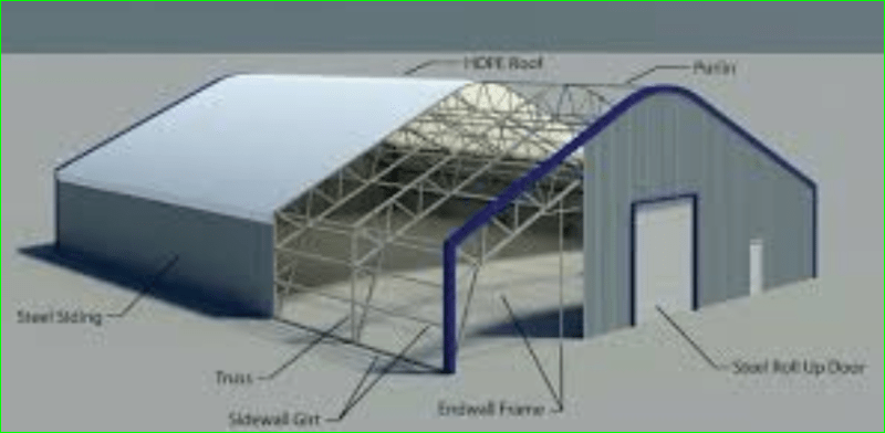

Are we talking about buildings like the one shown below? If so, what is L? The height of eave? What rationale can we offer for setting a particular limit on deflection due to wind? If there are no materials to be damaged, such as drywall or brickwork, which would crack if deflections got too high, why bother setting a limit?
If there is any danger of flutter developing in the roof as a result of wind, that would be something to worry about, but I'm not sure that could be readily analyzed. If the ends of the building are open, or perhaps closed at one end and open at the other, internal wind pressure could introduce a potential problem. The building designer may want to consider limiting deflection in certain unusual cases, but lateral deflection at the eave of a building similar to the one shown below, to me, seems pointless.
BA
Yes it is this type of building, but there is no steel cladding on walls, pvc fabric all around.
Eave Height 4.5m, apex 10m, 20m span x 20m long
