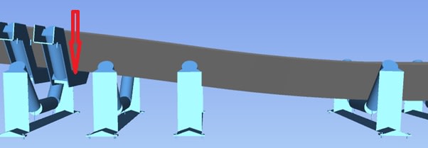

See snapshot of model above. Cannot really provide much more at the moment.
Essentially I need to find the load on the centre roller on the left hand suspended idler. Can see there is a lot of free belt between the suspended idlers and the shuttling idler on the right.
I believe i'll need to calculate the suspended belt length first, and then calculate the forces on the idlers.

My initial problem starts with finding the suspended length of the conveyor belt (lets treat it as a cable between supports)
Taking an Assymetrical catenary approach (Since the idlers, or in this case considered as simple supports, are at different heights) to the problem.
I've looked at many videos and resources on finding the suspended length, however each example resource requires sag in belt/cable to find length, or length to find sag. Therefore I'm in a loop of what to do.
See below small sketch of the problem and the FBD. I need to calculate the suspended length of the cable/belt. Once I do that I believe I need to find the forces at the supports (idlers) and hence the centre roller?
Help is greatly appreciated.
