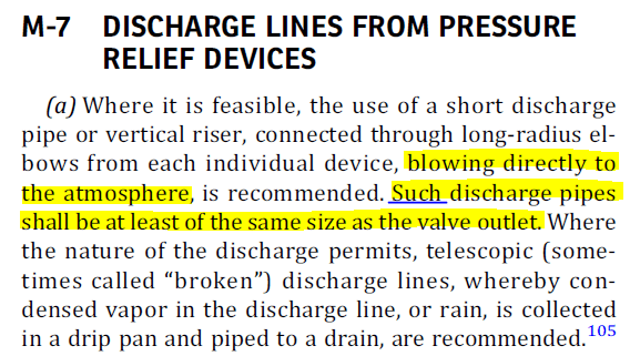

Don, thanks for the find. However, I still don't think that provision applies to the OP's situation.
From M-7.
(a) Where it is feasible, the use of a short discharge pipe
or vertical riser, connected through long‐radius elbows
from each individual device, blowing directly to the atmosphere, is recommended. Such discharge pipes shall be at
least of the same size as the valve outlet.
Where the nature
of the discharge permits, telescopic (sometimes called
“broken”) discharge lines, whereby condensed vapor in
the discharge line, or rain, is collected in a drip pan and
piped to a drain, are recommended.
When it says "such discharge pipes", I read that as referring to short discharge pipes that discharge directly to atmosphere - i.e. a "short discharge pipe". I also read the stipulation of "Such discharge pipes..." as meaning the size requirement only applies to the aforementioned "short discharge pipe". This is bolstered by the fact that M-7 then continues on in part (b)
(b) When discharge lines are long, or where outlets of two or more devices having set pressures within a comparable range are connected into a common line, the effect of the back pressure that may be developed therein when certain devices operate must be considered [see UG-135(f)].
No mention of a size requirement for "long" discharge lines, but rather puts the burden of proof on the designer to prove pressure drop is acceptable.
Lastly, M-7, part (d) says:
(d) All discharge lines shall be run as direct as is practicable to the point of final release for disposal. For the longer lines, due consideration shall be given to the advantage of long‐radius elbows, avoidance of closeup fittings, and the minimizing of excessive line strains by expansion joints and well‐known means of support to minimize line‐sway and vibration under operating conditions.
It seems clear to me that the code makes a distinction between "short discharge lines" (addressed in M-7 (a) and "long discharge lines" (addressed in M-7 (b)), especially since part (d) refers to "all" discharge lines. It also seems clear that the requirement for discharge piping size only applies to the "short discharge lines".
A final supporting point is a corollary : rupture disc relieving capacity requirements in UG-127 also make a distinction between "short" and "longer" discharge lines. "Short" lines have an inlet and exit discharge nominal size requirement in UG-127 (2)(-a)(-1), while "longer" lines simply stipulate (in (2)(-a)(-2) that total resistance to flow must be considered, with no requirement on outlet pipe diameter.
Overall, I don't believe this is a code requirement. Thoughts on this?
