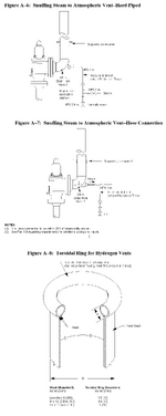

Note that your exhaust has not a toroidal ring which is the industry-recognized practice preventing H2 self-ignition.

Have you got details, diagram, links for that "toroidal ring" please?

The snuffing steam design can be found in ExxonMobil in the next post. Note the pictures in the next post - ExxonMobil guides the exhaust upward with no a rain cap.

ExxonMobil's std. GP 03-02-04
4.3.4. Addition: Ignition of a Relief Stream at the Point of Emission
1) Snuffing steam is required for PR valves that discharge greater than 50 mole % hydrogen or vapors above their autoignition temperature to the atmosphere. The Owner’s Engineer will specify when flammable vapors below their autoignition point require snuffing steam. Snuffing steam shall be installed as follows:
a) At least a NPS 1 in. (25 mm) steam line shall be tied directly to a separate connection on the discharge riser per Figure A–6. The steam isolation valve, normally closed, and a 3/4 in. (20 mm) bleeder, normally open, shall be located adjacent to each other at a safe location (typically grade) accessible to the operator. The discharge of the bleeder shall be directed to an open drain or catch basin. Or,
b) At least a NPS 1 in. (25 mm) line with a block valve and hose connection shall be separately connected to the discharge riser, per Figure A–7. The block valve and hose connection shall be located within 20 ft (6.1 m) of a steam utility station.
2) The snuffing steam line shall be traced and insulated if vapors leaking from the PR valve contain enough water to condense, freeze, and block the steam line.
3) Discharge risers for PR devices in hydrogen service at greater than 50 mole % hydrogen shall be equipped with toroidal rings according to Figure A–8.

1. The end of the discharge pipe shall be cut off squarely.
2. A toroidal ring shall be installed where hydrogen content of the vapor exceeds 20mol% to minimize the risk of ignition by static electricity.
Table 17: Toroidal ring diameter of Hydrogen-rich streams
Pipe diameter-------------------Toroidal ring diameter
Less than DN200 (NPS8)----------13 mm (1/2 in)
DN200 to DN300 (NPS8 to NPS12)--20 mm (3/4 in)
Greater than DN300 (NPS12)------25 mm (1 in)
