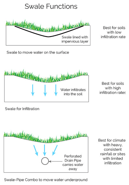

In my region lot grading plans are built into the approvals for subdivision, if your in a subdivision you may need to look at the impact of any changes to your drainage quantity and discharge location. I also find it odd you are considering drainage pipes for backyard grading instead of swales, which are typical. If you are planning on ripping up three 12 inch strips you might consider grading the entire yard to get water to perimeter swales. The below image is from Greene County in Ohio, and shows a back to front drainage pattern, other common types are front to back and split.

I like the idea of the swales but I am unsure if these will work for my application with regards to access around them and the look of them in the yard itself.

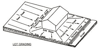

assuming that the wet ground is due to surface water (from rain), than your first step should be grading as recommended before to drain the water across/off your property or at least away from your house. You need to remove that water as quickly as possible, during the rain and after so that the surface can dry out. if you still plan on piping, than build a proper storm drain with surface inlets that will collect the water at the ground surface and drain it to a ditch.

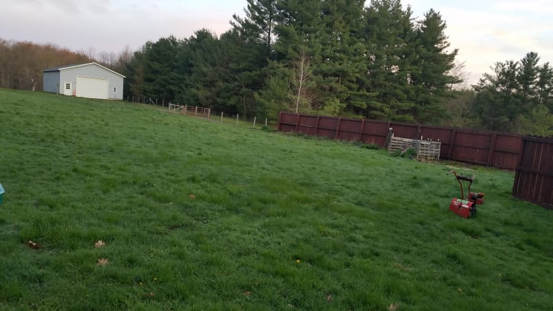

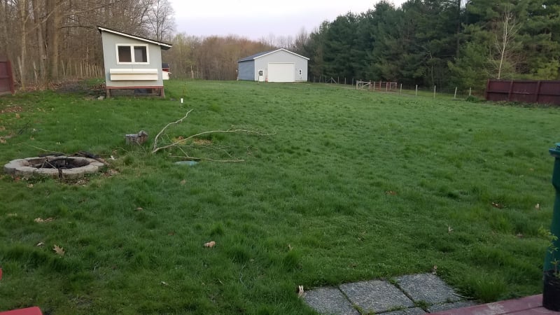

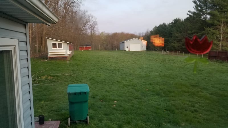

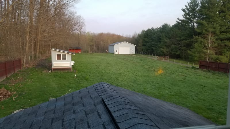

I will see about doing the test trench later this week and report back my findings. I have also attached a few pictures of the site I have been referring to.

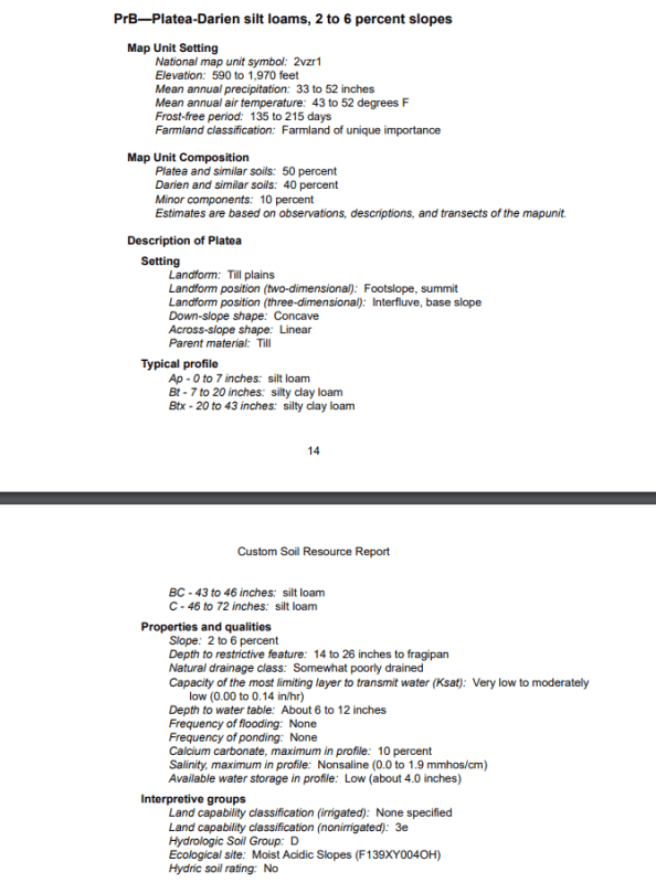

I have also attached the excerpts of the soil survey of the land. I hope this can help with what I have told you thus far and clear up any confusion.
Also, help me learn about what I need to do.
The AG soil info is great. This soil is somewhat capable of being drained with sub-drains. However, they have to be deeper than your original 12 inch depth to do any good. I'll look up the soil name and perhaps ground water depth will come up. Many times those names are used in other states and sometimes not. I'd like to see if they have what is called structure (by ag soil scientists). Tell that description to an engineering prof who teaches soil mechanics and you get a blank stare. That is cracks formed by annual drying and wetting leaving what are called "peds'. Means drainage is possible.
I noticed the perimeter vegetation outside the fenced area, in my experience you will have finer grained material or lower permeability soils near the pine trees. There is also a compacted driveway (which will act as partially cemented and water will pool in ruts) on the right side of the picture which I assume is blocking drainage to the right.

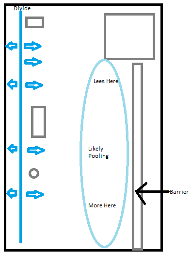

I would assume that you will be finding more soggy and muddy conditions on your lawn closer to the right side of the pictures before the driveway. In comparison the left side near the fire pit and red shed appear somewhat elevated and a surface water divide likely exists to the left of the small structure with a sloping roof. I believe the driveway is acting as a barrier and may be causing local pooling which will take longer to infiltrate due to a transition to lower permeable soils on the right side of the property. Below is a sketch of what I suspect is the problem. The solution may be to put a swale on both sides of your driveway and put in some small culverts. Also the fence on the right side closest to the house may be limiting surface water runoff if it is right on the ground.
Looking at the soil report for the area it says 72 inches of low permeability materials, somewhat poorly drained and water table 6 to 12 inches. From the photos I find it hard to believe the water table is that shallow. If this was a groundwater problem I would think you would notice foundation or buried utility connection issues.

If this is a surface water problem pooling water you would only need to do slight grading and any low spots you would need to connect with swale to culvert system or a catch basins/culvert system to a lower level outlet. If this is a groundwater problem you would need a lot of earthworks and you would want to cut drainage channels in a leaf pattern to a low elevation outlet on the perimeter. I don't think the problem would be as extreme as football fields which can have uniformly spaced drainage pipes and closer spacing for perpendicular sand groves.
Swale schematics

I do believe the water table is fairly correct though at least during the winter/spring time. I have dug quite a few holes for trees and bushes on the property and at about 8 inches or so I see Standing water in the hole. Some areas a little less and some a little more. The hole will gradually fill up to about a third of the way if left alone for an hour to a few hours.
I do think this ground is a clay type substance. It is vert sticky, wet and heavy.
I also think the soil surveys are fairly accurate as I have checked multiple sites that I know the soil to be and they were dead on from what I knew they should be.

What is that circle thing in back yard?

If you are talking about the green color circle in the ground, then that is the septic tank cover.
GeoEnvGuy: According to your picture of the troublesome areas you are almost 100% correct. The only area of correction is the area of pooling. I do not get pooling until the lower half of the right side where you have it labeled as "More Here" The driveway has some low spots and those always have pooling in them after a rain and a few days after. I also have very wet soil on the upper left side of the picture as well where the divide is located at.
